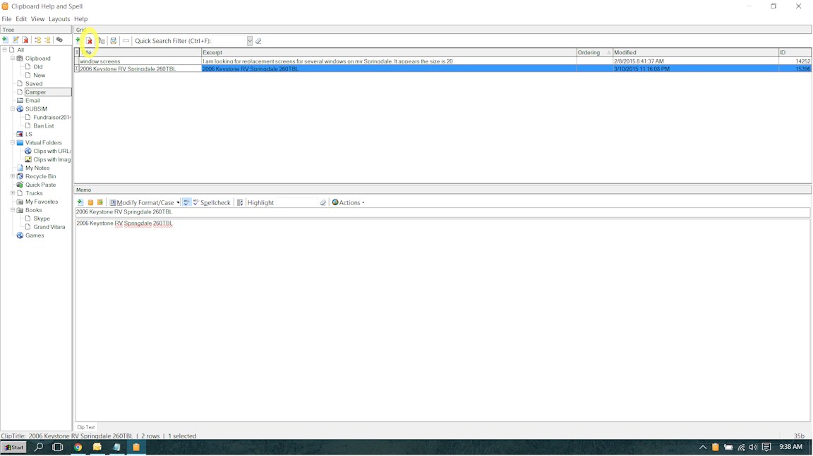

I use CSH a lot. I keep a lot of code and html, signatures and often used verbiage, and info in clips. I use it store password hints, and account emails and urls. I go and copy parts of CSH clips and paste into webpages, and visa versa. There a are a few major issues I have with CSH:
When I select a clip,  and highlight then ctrl-c a piece of the clip to place into a webpage or form, the CSH interface instantly shifts to some other, unrelated clip. I am no longer in the selected clip, and I have to find it and re-orient myself. What I would like to see is, when I highlight and copy, the interface stays the same, nothing happens. I am still in the selected clip, and my highlighted text is still highlighted.
Same when I have copied a bit of code or text from outside of CSH, and I go and select a clip and I want to paste it into the CHS clip. I should see the pasted text, in the selected clip, with not shifting and changing of the interface.
When I select a portion of a clip, I would like to be able to right click and get the copy paste menu, as with all the other Windows programs.
Also, when I go to a Group, it should have the windows vertical scroll bar at the top. As it works now, when I change groups, the scroll bar is at the bottom, even though I have the clips ordered. CSH is the only window or program where the scroll bar starts at the bottom.
The sub Groups: the clips in the sub groups are also in the parent group. I don't see why, I want the clips separate. I have sub groups under parent groups because they are related, but I don't want all the sub groups clips also duplicated in the parent group.
And I still cannot delete a selected clip. Never have been able to.
This is a terrific program, and I support your work.  I hope you can find time to add these improvements into the next version.

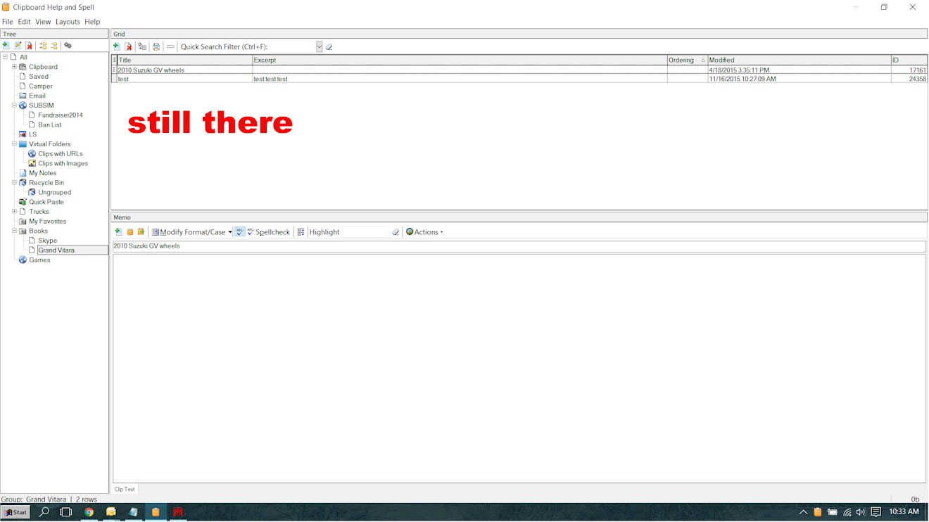

Yeah, my work around for the last 2 years is, since I cannot delete a clip, to empty the contents and reuse it.  8)  But I have been puzzled why I cannot delete.

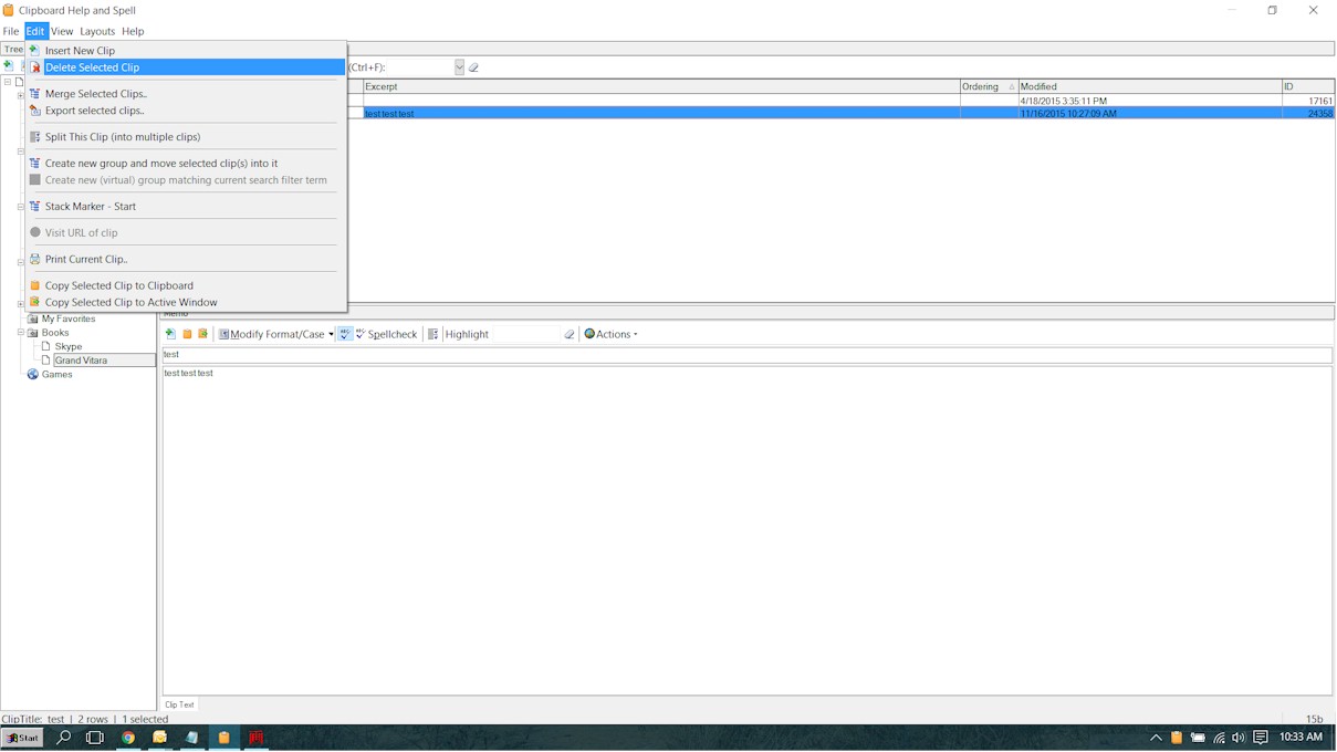

When I try to delete a clip, I click on the clip, part of it is highlighted, and I click on the icon with the red X, "delete selected clip(s)"
But nothing happens. I also try using Edit, Deleted Selected Clip.

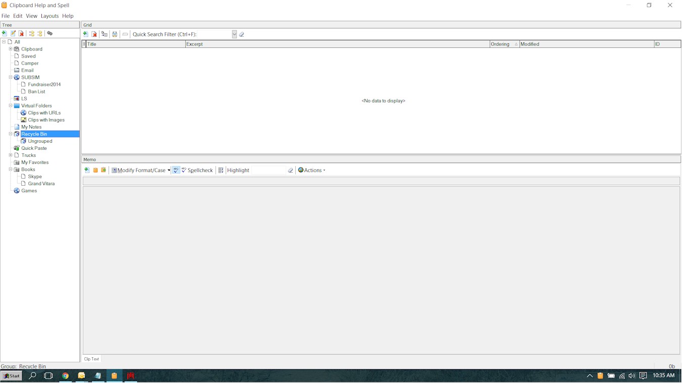

If you go in the Recycle bin and its children, do you see any clips there?

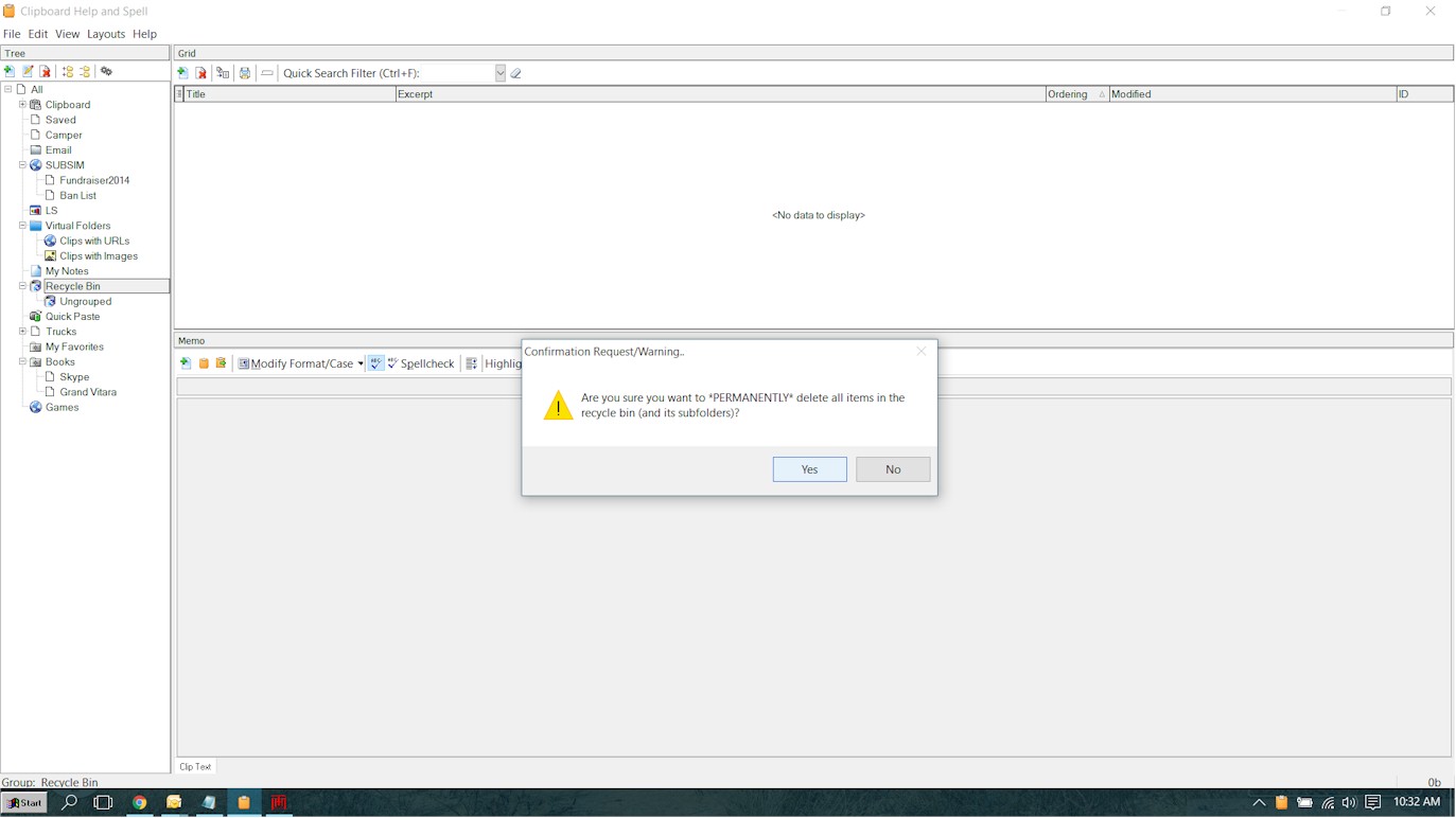

If you right-click on recycle bin group and empty recyle bin group, anything happen to the clips you tried to delete?

Edit: yes, I do see clips in the Recycle Folder, 527 rows. Cannot delete from there either...

I did right click the Recycle bin and emptied, and it did make them go away. Tried making a test clip in a normal group and deleted selected clip, still not deleting.

ok, exited the regular version, installed portable version. Clean database. Made a clip in Clipboard, and yes, it deleted it. Gone.
Made a new group, added three clips, and no, cannot delete every time.  :(    I can right click the group and Delete All clips in this group, and they go....

well i can't -- it's not acceptable for clips to not delete.. are you doing anything odd when you are creating new groups?
i may have to make you a debug version of the program to see if we can track down the problem.. any error message in the statusbar when you try to delete?
can you try this? empty your CHS recycle bin, then delete a clip that fails to delete, and look in recycle bin -- is it there?

Ok, tried Emptying the Recycle bin, it's still empty
Deleted selected clip,
clip not deleted from the group, and not in the bin
