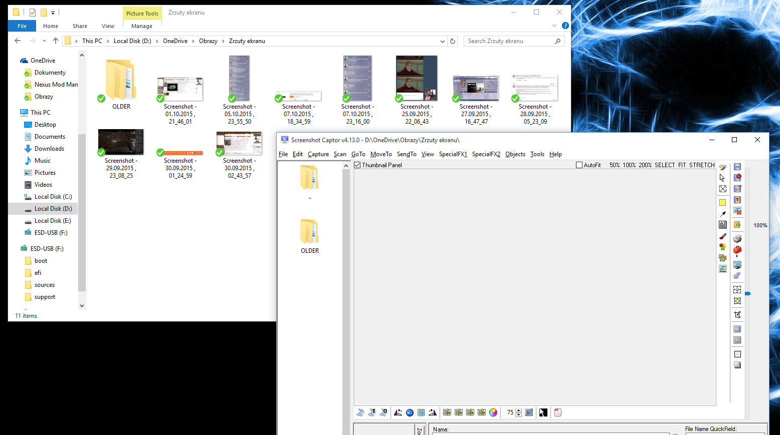

Hello, I've encountered a problem which is, I can't see the thumbnails on the thumbnail panel. As shown in the attachment, the images are in the right folder, but are just not showing.

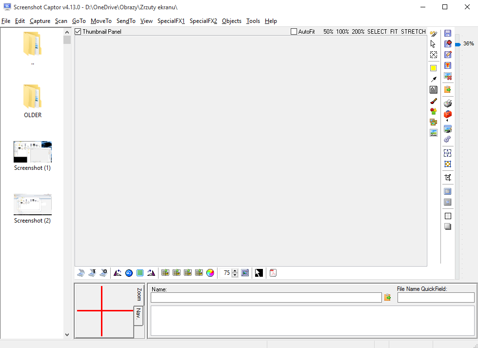

And I've also just noticed, that files named "Screenshot (1,2,etc.)" apparently have no problem with showing.
All of the screenshots are PNGs.

1. From what I'm seeing it's files with dots in their name that don't appear, for example "Screenshot 15.4" or "Screen.shot 154" doesn't get detected, while "Screenshot 154" does.
