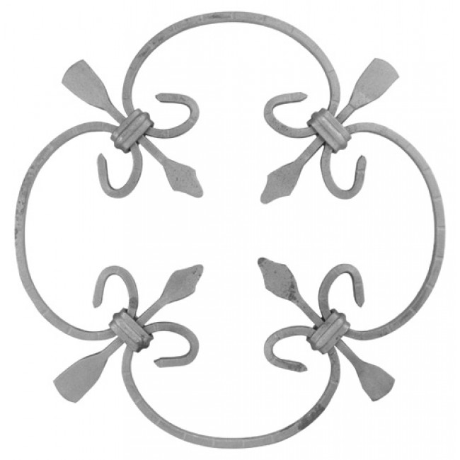

Ok that didn't exactly do what I expected . When I dragged the attached image to the Drop Zone in Firefox it created a shortcut to the original, but IE11 it was barred.
However it will serve as a means of mutual testing, and an unexpected feature. :)
