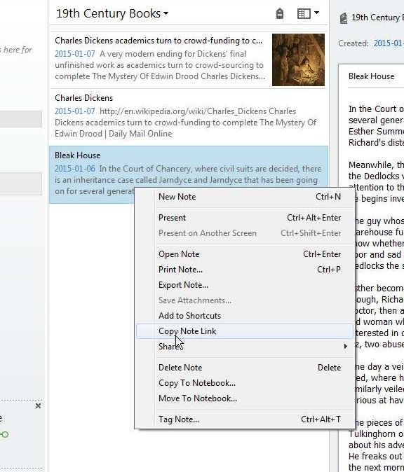

Thank's Mouser - I am attaching an example of what I've been able to do in the past - the important thing is that it shows a context menu from the Evernote program.
Up to now to capture context menus I have had to do a delayed screen capture - that 'technique' no longer works
I'm not 'wed' to doing a delayed capture  :)  But that was what worked for me back in 2012 when I obtained SC, but its its stopped working now, I am not sure when.

Its not Evernote specific, that was just a screen shot I posted on a Mobileread forum months ago that I was able to grab.
But some progress
I was able to get shots of context menu's in File Explorer, Evernote, xplorer2, 1by1, Irfan View, without using a delay.
