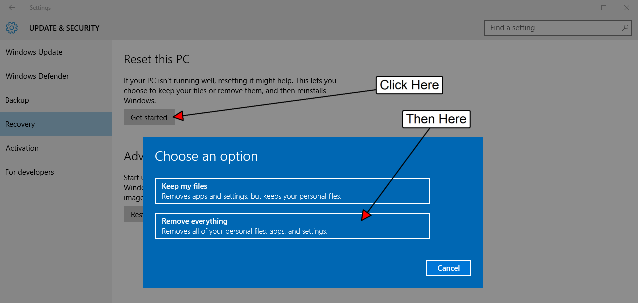

I'm pretty sure the Download Tool in Step 2 can also make a bootable USB for you. But if you're going to have to upgrade from Windows 7/8 anyway, why not just select the option to remove all your settings and programs and files and do a clean install during the upgrade? That's what I did.
Or why not use the "Reset this PC" feature of the OS?

Remove everything is different than a clean install.  I currently have windows 7 ultimate 32-bit installed.  I want to install windows 10 64-bit.
There's no upgrade path.  I have to do a clean install.
Ah, good point! But if there's no upgrade path, how will you get your 64-bit key? I'm not sure a 32-bit key will work for a 64-bit version.
