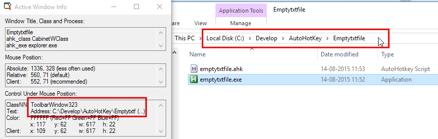

The text from this control comes prefixed with "Address: " on a US-English Windows installation, and "Adres: " with the Dutch language pack active (I have separate logins for separate languages on this Windows 10 system 8)), so the string-splitting is based on the ": " part.
I'm no expert on AHK, but it "Works On My Machine" (r) ;D
Can't test with Windows 7 (at the moment) or Windows 8.x (at all as I don't have that @#$#%-OS here), but as Windows Explorer has a lot of similarities I sortof assume it should work there too. Else use the AHK Window Spy to get the control-name that holds the address for the current folder:

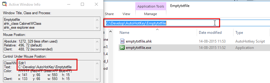

Only once the address is selected it reveals the Edit1 control as used in the original code:
