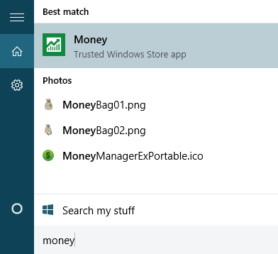

I'm running WinPrivacy on Windows 10... and I just got the weirdest request for internet access.
C:\Program Files\WindowsApps\Microsoft.BingFinance_4.5.168.0_x86__8wekyb3d8bbwe\Microsoft.MSN.Money.exe
I don't even have money installed!
Money is an app that comes with Windows 10.
My guess is that it's trying to update the "Live Tile" info.

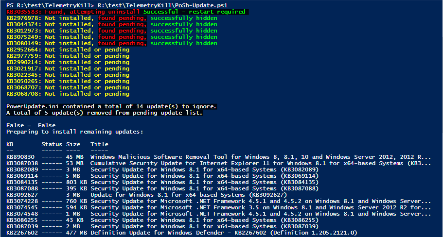

I've been having a play:

That looks very interesting. Can you also list (or remove) unwanted updates which have already been installed?
Re: Windows 10 Privacy Concerns
« Reply #104 on: September 09, 2015, 10:37 AM »
That's what the script I wrote up here does, although it just goes ahead and uninstalls them, (or at least tries).
But I was thinking of combining it with this one since it can use the same list of unwanted KBs.
Worked like a charm! Very cool actually. Thanks :Thmbsup:
« Reply #106 on: September 10, 2015, 11:47 AM »
You're welcome, nearly finished the next version - you can see what the output looks like above.
Just a couple of typos to murder and work out why global variables don't seem to be  :huh:

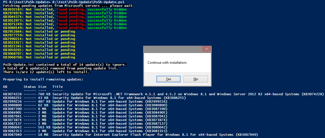

Still playing around with the next version, kind of got side-tracked (Real Life ... who needs it) I'll try and get it done in the next day or two.

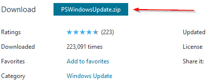

The following requires:
  • An elevated Powershell console (it will immediately exit if the console isn't elevated);
  • The Windows Update Powershell Module installed.
  • Minimum Powershell version required should be v2+ since that's what WUPM requires, (I'm not sure if there's any specific cmdlets that require a later version).
  • Some knowledge of Powershell ExecutionPolicy so I'm not answering questions :)
PoSh-Update.ps1

Write-Host ""
# If a restart was indicated during uninstallation, indicate it otherwise offer to install
# remaining updates
if ($restart) {
  Write-Host "A restart was indicated to complete uninstallation of one or more updates." -ForegroundColor Yellow -BackgroundColor Black
  Write-Host "Please do so before attempting installation of further updates."
  Write-Host ""
  Write-Host "You may re-run this script after a restart."
} else {
  Write-Host "Preparing to install remaining updates:"
  $updCol | Format-Table KB, Status, Size, Title -AutoSize
# Simple Yes/No requester
  $a = new-object -comobject wscript.shell
  $intAnswer = $a.popup("Continue with installation:", 0, "", 4)
  If ($intAnswer -ne 6) {
    Exit       # No
  } else {
    Install-Updates
Execution:
Extract PoSh-Update.ps1 and PoSh-Update.ini to a folder.
Open an elevated Powershell console, change to the folder:
powershell -noprofile -executionpolicy bypass -File "PoSh-Update.ps1"
What it does:
Checks for the existence of certain KB hotfixes, (read from the file PoSh-Update.ini, one per line), if it finds one it will attempt to uninstall using WUSA, it will also mark the update as Hidden so it's not downloaded in the next auto-update.
NOTE: Checking and uninstalling updates takes a few minutes, don't be impatient.
Sample output:
USUAL DISCLAIMER: It works for me.
« Last Edit: September 23, 2015, 11:01 AM by 4wd »

Spent some time wondering where Hide-WUUpdate was only to discover that this was added in the Windows Update Powershell Module in version 1.4.6 as mentioned here:
  https://www.powershellgallery.com/packages/PSWindowsUpdate/
Had inadvertently tried the 3 attachment links on the Module page and those happened to be for 1.3.4, 1.4.3, and 1.4.5...doh!
« Reply #121 on: December 10, 2015, 12:26 AM »
I use this link:
ewemoa
  • Posts: 2,922
« Reply #122 on: December 10, 2015, 01:08 AM »
That's what I ended up using in the end :)
