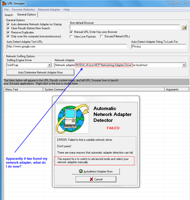

New user, am having the same problem.
URLSnooper notified me that Automatic Network Adapter Detector Failed, but it really did not fail because it shows my correct adapter [NVIDIA nForce MCP Networking Adapter Driver]
>  I have disabled Auto determine network adapter on startup
>  URLSnooper.exe is set to run as administrator
>  Problem exists whether Windows Fire Wall is on or off.
>  URL Sniffer v2.28.01
>  Problem exists with the latest version of Wincamp v4.1.2 and with the prior version 4.1.1

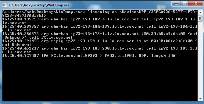

I installed Windump and it is using [NVIDIA nForce MCP Networking Adapter Driver] without a problem.

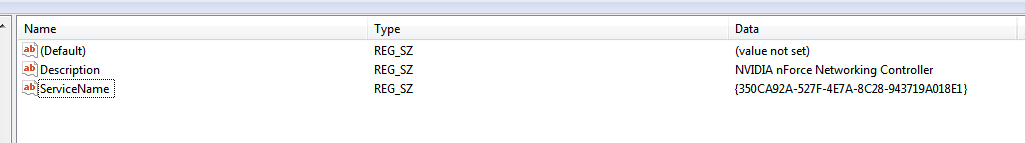

In my Windump screenshot you can see Windump listening on NPF_{350CA92A-527F-4E7A-8C28-943719A018E1} .
I also took a Regedit screenshot showing that NPF_{350CA92A-527F-4E7A-8C28-943719A018E1} is the NVIDIA nForce MCP Networking Adapter Driver
I can only conclude from this that if another Wincamp application is working fine with my network driver then there is something faulty in URLSnooper?
