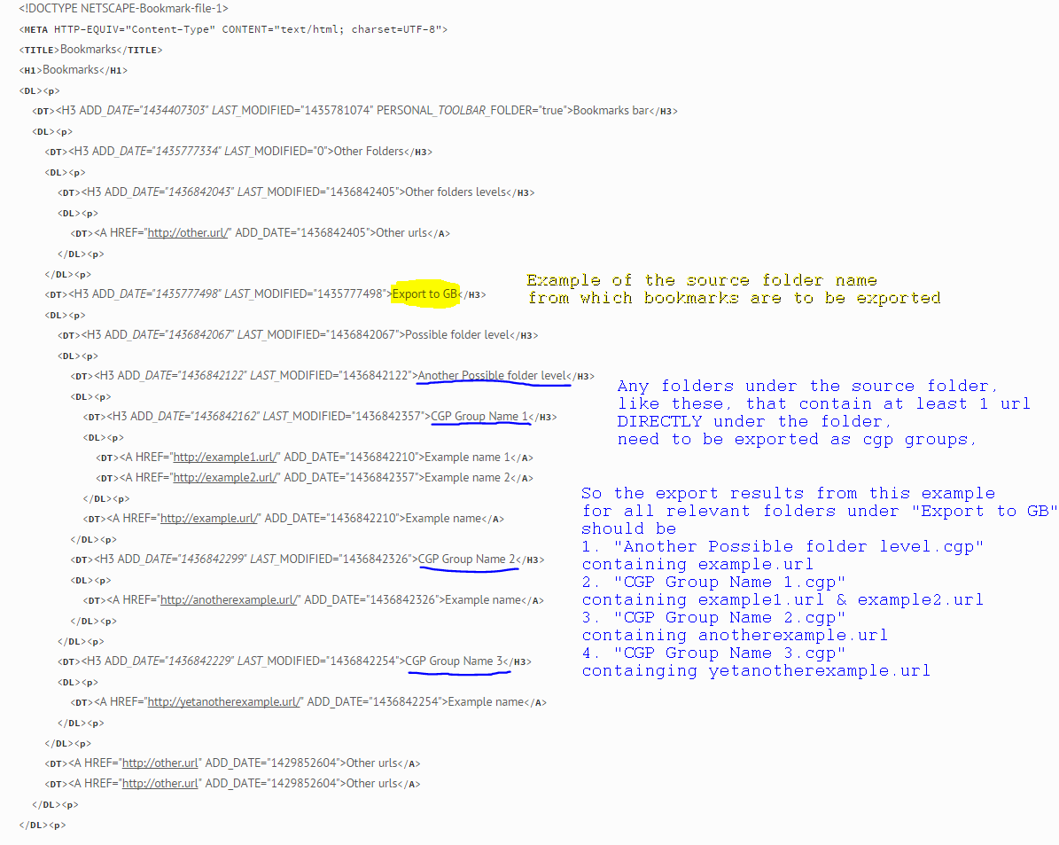

As for the Chrome bookmarks html file, I've also included a sample export. (Please see attached file for reference, the contents are too long to post here.) I don't know much about html formatting, but after analyzing the content, I believe, the main thing that's required to have Slimjet (Chrome) recognize the urls and their names, is to have each be reformatted from the above into such a format:

Additionally, each group name can be stored as a folder name for the bookmarks, which would be at a different level than the individual urls in the html formatting, and lastly everything should be stored under a unique top level folder name, perhaps based on the date/time generated, or allow user input, so as to avoid overwriting or mixing in with existing bookmarks when importing.
Finally, a crucial thing to note is that although the groups are stored in *what I believe* to be ANSI encoding (someone can examine the file and correct me if I'm wrong), they actually can contain any number of characters, some of which are not included in ANSI, such as this  ・ (U+30FB) or  ・ (U+FF65). (If you cannot correctly display the symbol, see the wikipedia link here and jump to the Japanese section.) They are sometimes stored as just a "?" in a Green Browser group file due to the limits of the ANSI encoding, and there can be quite a few of them. The program needs to be able to handle the symbols, but does not need to preserve or restore the original symbols. It merely needs to be able to at least put a space in the place of these, or remove them (ideally, an program setting option to decide which would be best). I have on hand a small program that's suppose to be able to convert from Green Browser groups into IE favorites, and it would generate errors and fail at the conversion randomly, likely due to these characters. I've attached it here as well if someone wants a reference point. The program I'm requesting to convert to Chrome bookmarks html needs to be able to handle these symbols without failing in the same way.

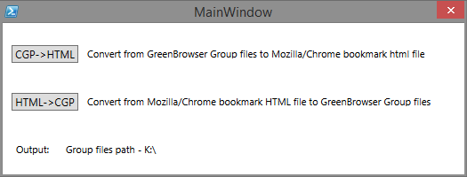

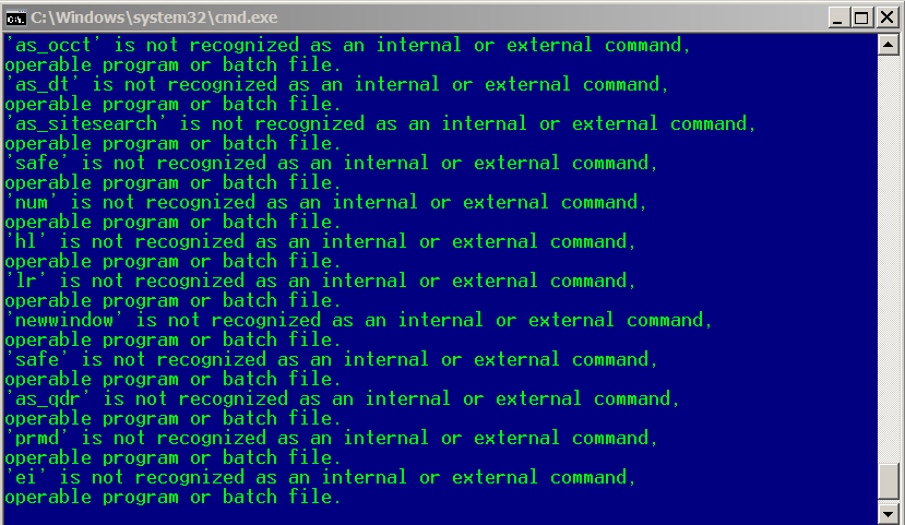

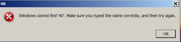

[attachimg=#1][attachimg=#2]

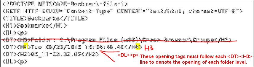

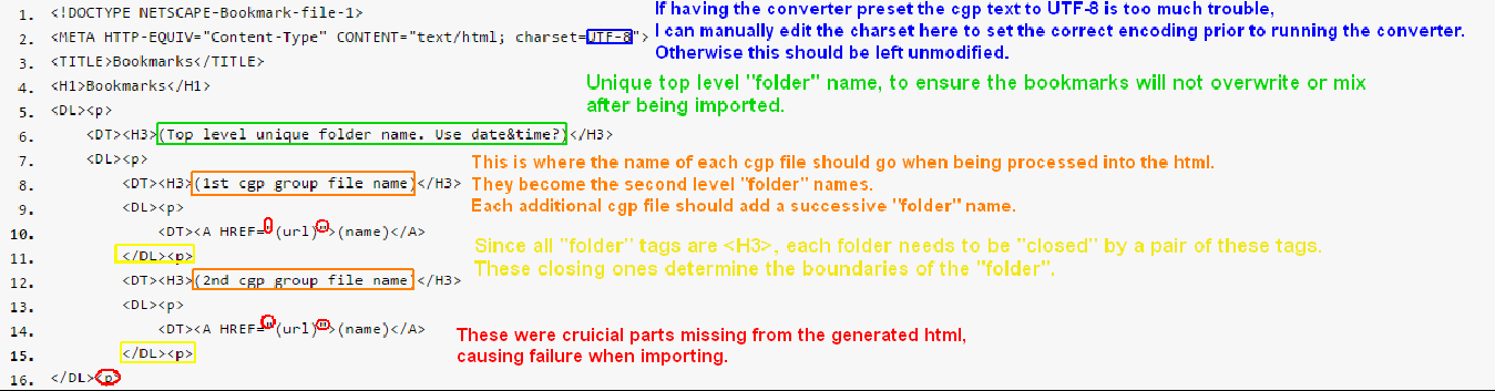

1. Unfortunately encoding conversion still isn't working right. The non-Romance characters still end up as gibberish when imported. Since the mojibake ends up with even more unusual symbols than normal being displayed when using a wrong encoding, perhaps it was one such character/symbol that caused the app to generate an error and exit? This appears to be something strangely similar to what happened with the convertor for cgp to IE favorites.
2. The unique top level "folder" name needs to be <H3> tag, not <H4>, or it will not be properly imported into Chrome/Slimjet. Any and all following folders after that also needs to be <H3> tag, preceded by <DT> and the contents enclosed by a pair of
Code: (text)
<DL><p> tags
The importing process doesn't recognize anything else. The only things denoting the boundaries of each folder are the
Code: (text)
<DL><p> and </DL><p> tag pairs
Everything following the DL tag and before /DL tag, regardless of whether it's a <H3> folder or an url, will mean that it's inside that particular "folder". So if you want to create different layers of folders, you only need to make sure the pairs are placed appropriately, which means the "folder" names always need to be <H3> tags and MUST be followed immediately by an opening DL, p tags. Current html is also missing the DL, p tags after the top level folder. The basic code I've included in my second post are what I have tested to work, so it should work as long as the format in the generated html closely follows that.

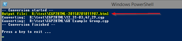

[attachimg=#3]
3. If it's not too much trouble, it's probably best to have the file name of the html generated include date as well as time. Otherwise there will still be a small but distinct possibility that it will conflict with an already generated file name. e.g. instead of "CGP2HTML-%hour%%min%%sec%.html", how about "CGP2HTML-%year%%month%%day%.%hour%%min%%sec%.html"?
4. One additional issue that just occurred to me when looking over my cgp files. The file names of some cgp files themselves can be in non-Romance characters. Let's consider together how we should handle this once the other issues have been resolved.

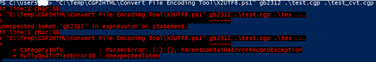

It seems many of the commands are not supported in my Windows 7 SP1 x64 (Ult). Is there some extra dependency?
They are not commands, they're fragments of the url/name that is read - something that wasn't a problem in the abbreviated .cgp in your OP.

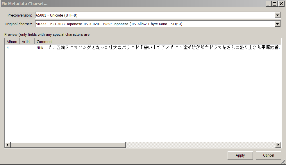

In Chacon, which is used to fix tags for audio files, it provides a preview window to allow you to switch between each encoding and see immediately if the characters are displayed correctly, i.e. if the correct source character encoding is chosen, prior to conversion and final overwrite to the tags themselves. It allows non-Unicode characters that was generated on one computer to be displayed correctly on another computer with a different system locale. The preview is useful due to the fact that not only do you have no idea what system locale was used on the computer from which the file originated, even when you know the actual language the characters are suppose to be in, the encoding itself doesn't always match the actual language of the characters used. With a large enough characterset, it's possible to display nearly all other characters from other languages in the same characterset intended for another language. e.g. It's possible to display Japanese characters using Chinese encoding, and maybe vice versa. (It's also why most European languages only have one "Western" charset.) However, sometimes there are some characters not included, and another important function of the preview is to allow you to see what might be lost if you chose a certain encoding, and which encoding might retain the most info, etc. I didn't think it would've been necessary to do it this way for converting from ANSI into Unicode, but I overlooked the fact that Unicode is ultimately still just another encoding, albeit one that is able to include all languages.
I will understand if you consider this too involved to implement. There is always the option to set it aside. I can try manually editing the "UTF-8" field for the right encoding. In your first version of the tool CGP2HTML, the html generated was able to be displayed correctly after I edited the "UTF-8" field to the correct encoding that I assume the text was originally saved in. If you just obtain the text without attempting to convert (or however it was done in the first version),  I can manually edit this field into what I think might be the proper encoding, based on the non-Unicode settings of the system it was generated on.

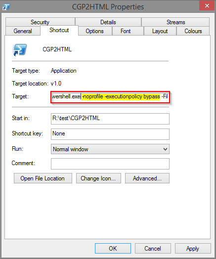

It's set to Simplified Chinese input but that can be changed by editing one value or I could change it to use whatever the console is using, (entering a value gives more flexibility I think).  Line 27 in script is where it's set, eg. gb2312 = Simplified Chinese, (PRC).

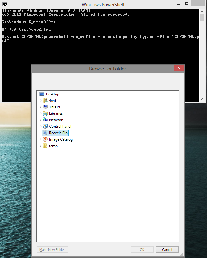

Double-click the shortcut to run it, (needs to be in same folder as the script unless you edit the shortcut properties).

I'm getting a window with errors when double-clicking the shortcut. It was gone too fast, but after several tries I managed to capture this scrnsht. After some research, it seems this is due to the fact the default security settings in Windows does not allow the execution of unsigned scripts. Is there a way you can sign it? Or do I need to permanently set the security level to "unsigned" in order to run the script? I hope there is a more secure workaround to avoid opening a permanent security risk for all unsigned scripts on my system.
I found this while searching for a solution. Perhaps you can make use of it, or help me understand how to use it?
On my machine that I use to dev scripts, I will use -unrestricted as above. When deploying my scripts however, to an end user machine, I will just call powershell with the -executionpolicy switch:
powershell.exe -noprofile -executionpolicy bypass -file .\script.ps1
« Last Edit: June 28, 2015, 03:14 AM by Cocoa »
Try adding the -noprofile -executionpolicy bypass switches to the command line in the shortcut.
EDIT: This worked, it allowed the script to run after I changed my policy back to AllSigned, (mine's normally at RemoteSigned).
BTW, you did amend any path in the shortcut to point to wherever you've put the script, right?
Yes, but that means you'd need to import a certificate into your system that I create - bit much for one script.
« Last Edit: June 29, 2015, 04:32 AM by 4wd »
Cocoa
  • Joined in 2015
  • Posts: 16
Tried it, but this time all it shows is a blinking white input cursor  :huh:
Which path exactly do you mean? If you mean the "start in" box for the shortcut, I removed the old path. Based on previous experience with shortcuts in general, I didn't fill in any new ones because I didn't think it was necessary, but now I have updated it. As with the previous result, running the shortcut gets the same white blinking cursor and nothing else.
After further consideration, I've also tried replacing the -File with -"C:\Program Files (x86)\Green Browser\Groups", which is where the cgp files are stored, but this time I once again got a window with red error messages that disappeared too fast for me to read or screenshot. I tried running it repeatedly after that to capture a screenshot, but it seems all I'm getting now are blank windows that last less than a second, without the error messages anymore.
-File with -"C:\Program Files (x86)\Green Browser\Groups", which is where the cgp files are stored, ...
The -File argument points to where the script is which is why I said this:
So, if you extracted the script into the folder C:\Powershell Scripts and put the shortcut on your Desktop, then the shortcut needs to be edited to show:
%SystemRoot%\system32\WindowsPowerShell\v1.0\powershell.exe -noprofile -executionpolicy bypass -File "C:\Powershell Scripts\CGP2HTML.ps1"
I updated the shortcut in the archive with the necessary parameters.
You could also start a CLI, change to the folder where the script is, and type in the command:
powershell -noprofile -executionpolicy bypass -File "CGP2HTML.ps1"
FWIW, running via the shortcut works on all the machines I have access to here, when run from a flash drive.

Don't take it the wrong way but a small piece of advice: read slower ;)
The file will be named CGP2HTML-YYYYMMDDHHMMSS.html and will be in the parent of the folder you chose, (or if it was a root folder it will be in that).  See update.
And no, it won't appear as yellow on blue, that's just the highlighter of the screen capture program :)
UPDATED:
Added: Colour output
Added: Check for Powershell version
Fixed:  Output is to the selected folder
« Last Edit: July 01, 2015, 07:30 AM by 4wd »

Something for you to test: HTML2CGP
Still in Powershell, has a simple GUI:
Extract all files to a folder somewhere and double-click the shortcut to run.  You should see the normal PoSh command window open then hide and then the GUI opens.
Two buttons, self-explanatory, the Output: line will have simple instructions, (choose file/folder), progress messages, (converting file xxx, etc), as well as show where the output went.
I've changed it so that it uses whatever the system character encoding is for the input and output, (at least I think I have, it's a bit hard to test since I'm stuck with English :) ).
eg. If your system is set for Simplified Chinese then it should read/write the .cgp files in that language.  However, if your system is set for OEM437, (or something), and the files are Simplified Chinese characters and ANSI encoded, then you'll get something indecipherable.
That's what I got anyway, even though I'm set to OEM850 the output files were byte identical to the original input files after converting to HTML and then back to CGP, so in theory it should work.
Requires Powershell v4, should open a requester if you haven't got it (haven't got anything to test it on).

HTML2CGP:
Like before, the conversion works perfectly for converting from cgp to html, but when converting back from html to cgp, it's actually not quite as straightforward due to the more complicated format of the html file.
There are several things that needs to be addressed:
1. Slimjet exports ALL bookmarks as a single html file, without the option to exclude, but I neither need, nor want the entire bookmark collection to be converted back into cgp groups wholesale. So I would really like an option to specify a folder name that the exporter should look for, for example "Export to GB", under which I will copy over all the bookmarks and their folders that I actually want to be converted into cgp. Additionally, the folders under this folder might have multiple levels (nested folders), and the export needs to be able to export only those that have urls (bookmarks) DIRECTLY under them, while retaining the folder name as the cgp group file name. (Please see screenshot for clarification on what the format might be like.)
2. Since the folder names are to be converted into cgp group file names, some folder names may contain characters that are illegal for Windows file names. If the converter runs into any of them, it would be immensely helpful to have it auto-replace the illegal characters with an underscore "_"
[attachimg=#1]
[attachurl=#3] (html format of the above example)
X2UTF8:
I hate to bother you about this in addition to the converter, but I tested the script with different files, and it seems it's not accepting the encoding names. First I tried Shift-JIS, and then I switched to a cgp file, using the "gb2312" you gave as an example, but I kept getting the same error as below:
[attachimg=#2]
« Last Edit: July 14, 2015, 09:47 PM by Cocoa »
