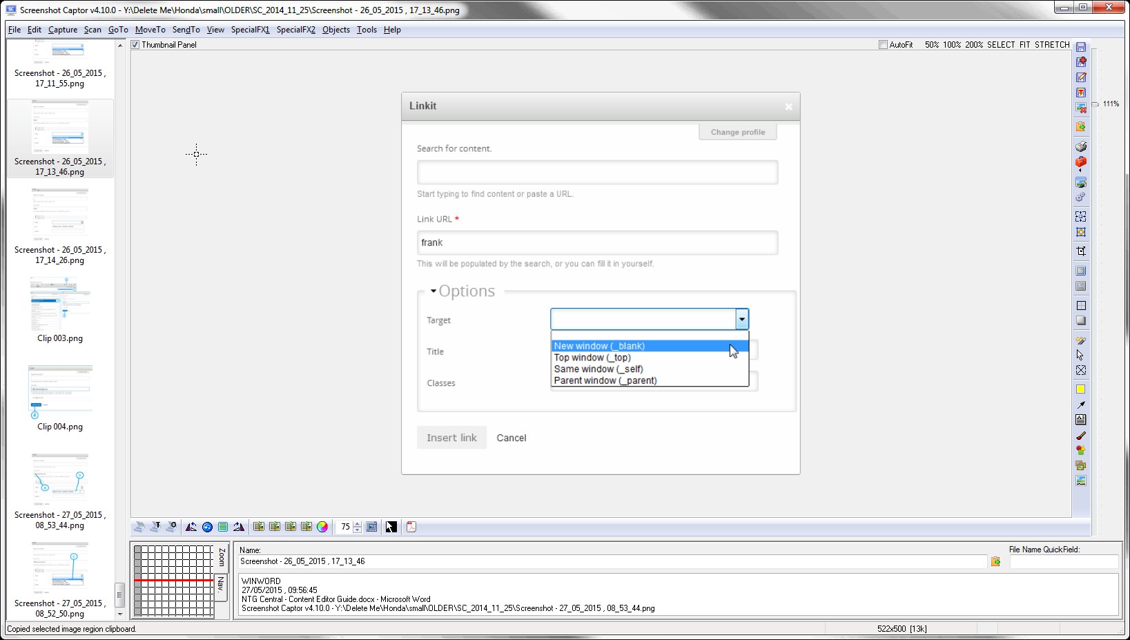

Hi Mouser,
In my Screenshot Captor window I have a screenshot of a popup which has a fine border around it. Whenever I select the image (Ctrl-A) and then paste it into another application such as Word, IrfanView or Gimp, the bottom and right lines are cropped. How do I prevent this?
Currently, to get around this, I expand the canvas, but that is a bit tedious.
Using Version 4.10.0
Thank you.

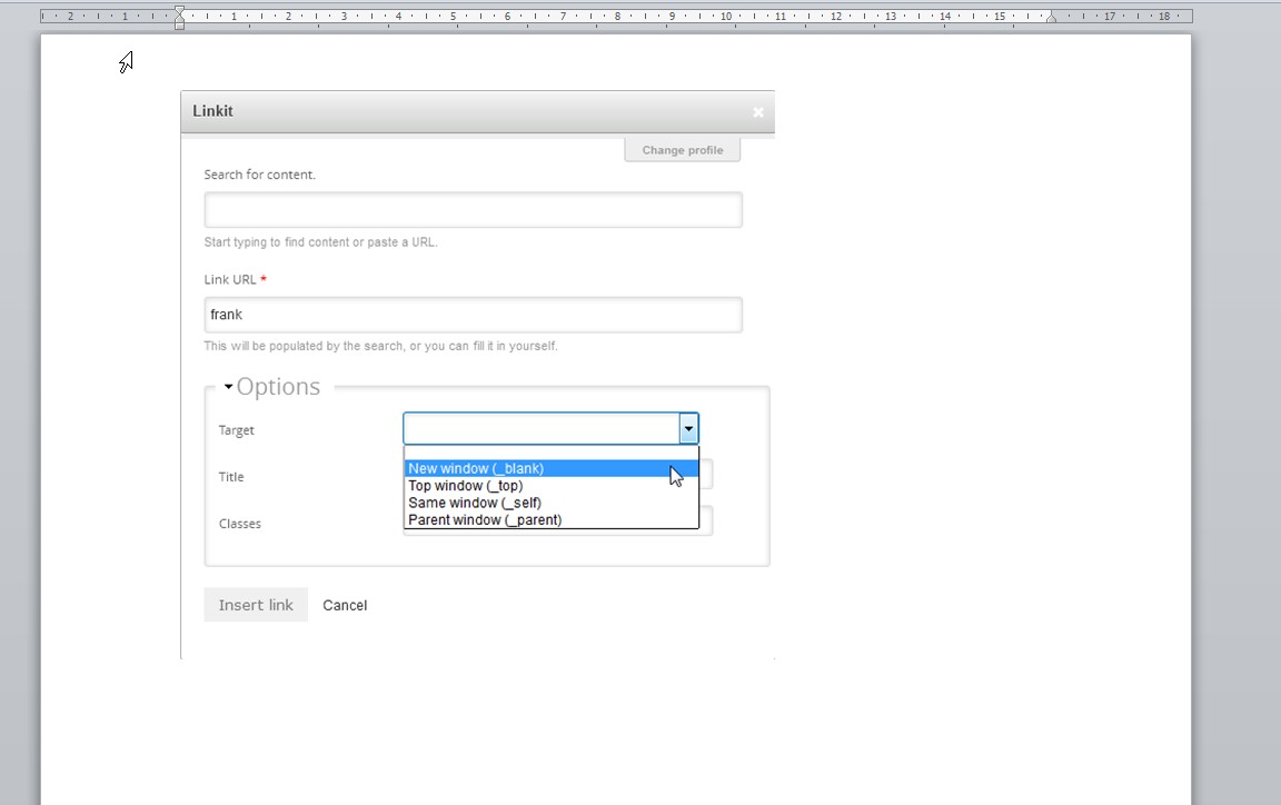

I installed the new beta and tested copying and pasting.
I copied from the main SC window using Ctrl-A and Ctrl-C, then I pasted into Word and IrfanView. I checked the results and the pasted images appear to be exactly as what was copied - nothing cropped and nothing added.  :)
