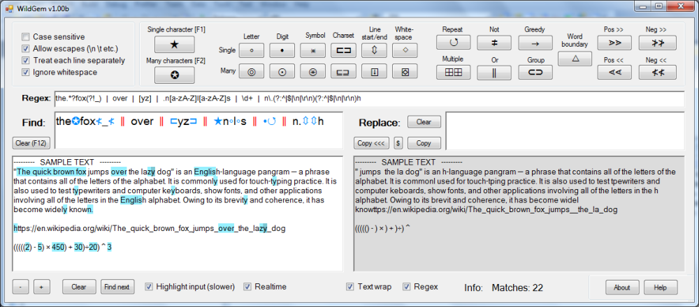

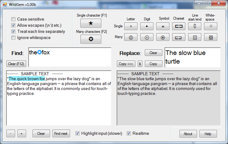

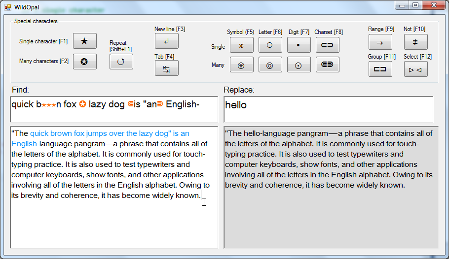

Well, I've got a beta, but stable and fairly polished feature-packed version complete. Love to hear some feedback from pro regex users and people who don't have a clue about how regex works. Even if you're not interested in the unique "unicode symbol" way of doing things, it's a pretty nice regex editor anyway.
Here's a couple of screenshots:
« Last Edit: June 07, 2015, 02:21 PM by Twinbee »
