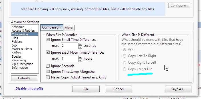

I have used Clickteam SynchronX and it has worked well for me - http://www.brothersoft.com/synchronx-4732.html
Dopus doesnt do this.
Snycovery looks like it can do this - but for some reason it's greyed out here:
One problem with the larger file replacing smaller is if a more recent file is slightly smaller, it will get replaced by older version - but this may not be relevant to your situation.
Syncovery gets around that by only doing it for files that have the same datestamp.

Syncovery will move the data - so source drive should be empty at the end if your settings are correct -
re the greyed out options - the author is extremely helpful so should be able to clarify what's going on there. There is a forum I think too.

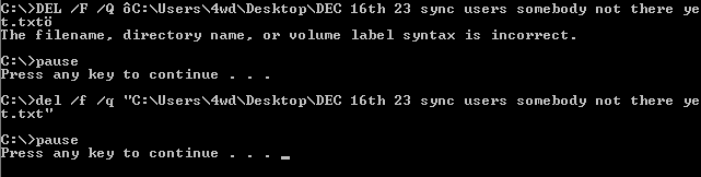

DEL /F /Q “C:\Users\ASA4\Desktop\DEC 16th 23 sync users somebody not there yet.txt”
Look at the quote marks.
It'll look the same as normal quote marks at the DOS prompt but it won't work, the following will:
DEL /F /Q "C:\Users\ASA4\Desktop\DEC 16th 23 sync users somebody not there yet.txt"
To illustrate:
Command file - top line is taken from posts above, third line replaced the quote marks with normal ones off the keyboard using Notepad2 (which makes the difference more obvious):
Result:
The angled quote marks are usually caused by a word processor, with a basic text editor they always look like a pair of vertical parallel lines.
Fixed command file without the funny quote marks:

REQUESTS from all of you who have been so helpful on this:
I have been looking for the fix to the issue that 4WD caught with the "quote marks" and I am sure I have seen one somewhere.  it is a patch or setting or something that makes ALL Quotes be the RIGHT quotes for someone who works on scripts not for people typing letters.  I am not sure but it may be a windows thing where you tell it not to use "smart-quotes" anywhere.  I never want to have to deal with the DUMB QUOTES again.  That was too much. :-[
I also need ways to modify the specs on this nifty "junk cleaner" script.  What is the right way to tell it to look for all files ending in (for example)  .tmp"???"
For this type of Archive I would love to search for/review/(and probably delete) all the ".exe" or ".com" files.  I have found during my transfers that there are quite a few and some are being scanned and removed by MalwareBytes or AVAST anyway.  OLD viruses and Malware that were, at the time, not in the database but are now.
And there are other extensions that if  could find them ALL just like I am finding the zero length files and have the option of removing them ALL  Or I could change the first echo command to "xcopy" so I could copy them to elsewhere before I ran the DEL version to get rid of them.
If I had been doing these from the start I hate to think how many junk files I now have in my nice clean 5TB Complete Documents Archive.
I need to come up with  list of "JUNK" like that and create a statement to cover each.  Another is those files created by WORD with the " ~ " as the first character to be a "ghost" copy of the file you are working on.

I would have thought that the type of files you want to keep would be a much shorter list than the type of files you want to remove.
But if you want to check on file extension just use that for the comparison instead of file size, eg.
"%%~xF"==".tmp"
IIRC, the ~ Word files all have an extension of .tmp so will be picked up using extension comparison providing you've also searched for hidden files.
« Last Edit: June 08, 2015, 11:54 PM by 4wd »
Code: (text)
   @echo off
    echo @ECHO OFF>> zerobytefilesremover.bat
    for /r %%F in (*) do (if %%~zF==0 echo DEL /F /Q "%%F">> zerobytefilesremover.bat
                         ) else (
                            if %%~zF==".tmp" echo DEL /F /Q "%%F">> tempfilesremover.bat
                            ) else (
                                <fill in other arguments/conditions if you like>
IF...ELSE... structure is allowed in batch script. But it makes the execution of it (a lot) slower. Just make sure that when you use the () characters in a script, you terminate each condition properly with a ). Decent text editors light these characters up when a set is terminated properly...so if you select one such character and it doesn't light up, you have to investigate your code. Although this lighting up is a great help, it won't save you from all possible error scenarios with the use of () characters.
But that is something you learn best the hard way... ;)
Code indentation is your friend. It makes working with IF...ELSE... structures easier.
Another word to the wise, don't start the holy war between the use of spaces or tabs for indentation back up...  :D
Should be %%~xF   ;)
