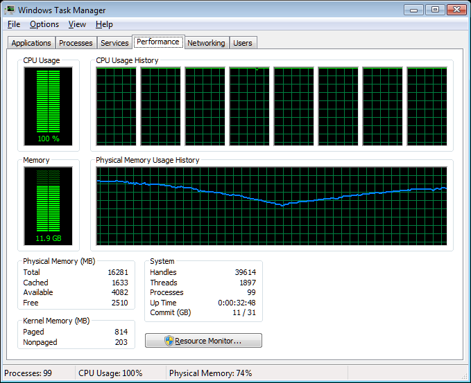

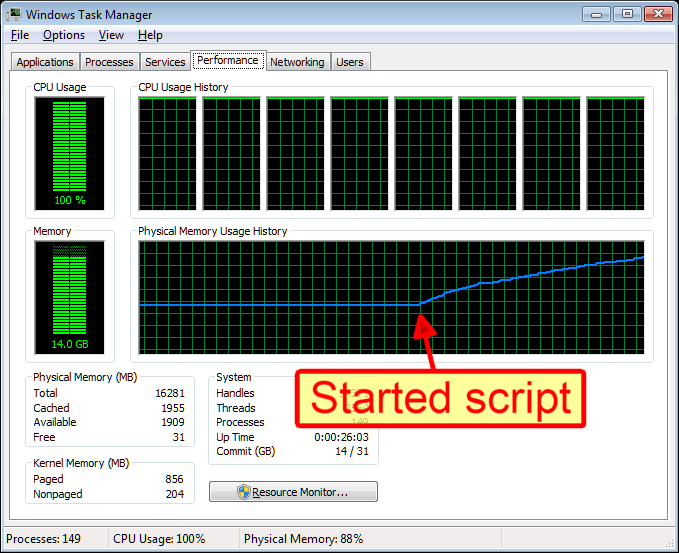

Yeah, that script definitely caused issues. I moved all the images that were already kept into another directory so it could just resume from where it left off and started the script up again. Here are some screenshots of behavior I saw.

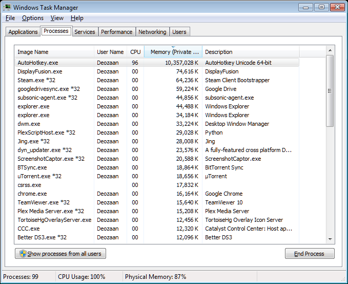

As expected, it immediately maxed out my CPU usage to 100% and made my computer somewhat sluggish (occasional "hiccups" of unresponsiveness). I opened the task manager to take a look at the CPU usage and noticed the RAM usage climbing sky high:

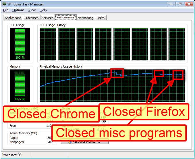

RAM usage kept climbing, so I closed out Chrome, Firefox, and other misc. programs, anything using more than 100MB of RAM got shut down.
The RAM kept climbing up, but soon peaked around 13-14GB of RAM(!), and then started alternating between going down and climbing back up, like so:

From the cpu patterns, but more significantly the memory patterns, use you are describing, it sounds like what may be happening is that the delete function (perhaps because it is sending files to recycle bin), is being run asynchronously and creating a new thread for each iteration of the loop, so that essentially the loop is creating thousands and thousands of threads trying to delete files at the SAME TIME, while the loop runs super spawning all of the threads/processes -- rather than it processing each one in turn.
Alternatively, it could be an antivirus program having the same effect.
It would be one thing for the cpu use on one of your cores going to 100%, but the memory use suggests that each iteration of the loop is causing something to be spawned.

I set up a couple of test folders, each with 80,000 one meg files.  From my tests, using FileRecycle will cause the issues you saw.  When I used FileDelete, the script took about five seconds to run with little to no hit to CPU and RAM.
