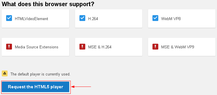

Just as a matter of interest, does the same happen with HTML5 content?
https://www.youtube.com/html5
This is IceDragon, (Comodo's version of Firefox):
Click the button to have Youtube try and serve videos in HTML5 rather than Flash.
I'd also uninstall the Flash Player while testing, (just to make sure).

4wd - yes, I know about that and have turned it on and off to no avail.
Oh - you mean to enable html5 with Flash uninstalled?
I'll have to try it out.
