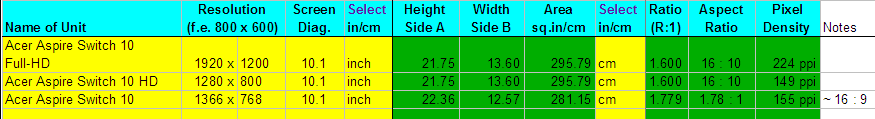

This is very helpful -
looking at the Acer Aspire Switch 10 and trying to figure out the options:
thanks brahman :up:

Please note that 1,778 is 16 : 9, so 1,779 : 1 is almost 16 : 9. That means this model will be slightly longer yet slimmer than the other two.
This may be useful when you want to read in landscape mode.
Regards, Brahman
^yep, that's what I was trying to figure out (I was suprised they had the same model with different ratios).
But also the ppi - not sure if higher is necessarily better if I want to use the desktop on that size screen

If you go to the monitor section of the Screen Calculator you'll see that most monitors have around 90 ppi, a Full HD 1920 x 1080 24 inch - which is todays most commonly used external viewing device - has 92 ppi.
Your lower two devices have around 150 and the top one 224 ppi.
In order to make fonts and graphic elements visible, the manufacturers usually scale up the dpi by 120 or 130% in these small devices.

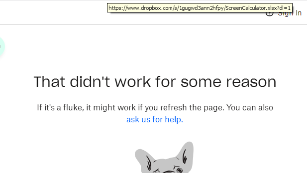

hi, i can't download any version of these spreadsheets, and i'd be interested in both
the err i get is
"That didn't work for some reason
If it's a fluke, it might work if you refresh the page. You can also ask us for help." with screenshot
while i'm also interested to figure out monitor screen without physically being in location, so far i only found a site that displays something and measures it from there, but what if i can't access that site and need to figure it offline? so maybe these spreadsheets help a bit
is there an easier way to do it?
i have access to system properties but does not help figure make and model so can't always look for that either
thanks for any help
