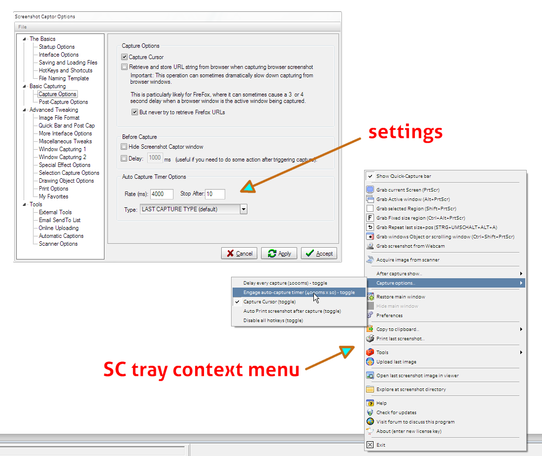

hi janvg
there is an autocapture option - I dont see any way of making a hotkey for it though - only seems accessible via the tray context menu (?)
Edit // I dont use it myself - it looks like you toggle it on/off and it will then work automatically when you press any of the capture hotkeys.
Try it out :-)

I tried it, but quality is a bit disappointing  :(

in my experience, that's generally the case when taking stills from video - unless it's very high resolution footage and there's not much motion in the scene.
I would suspect that SC is not to blame, as it records exactly what is on the screen.
