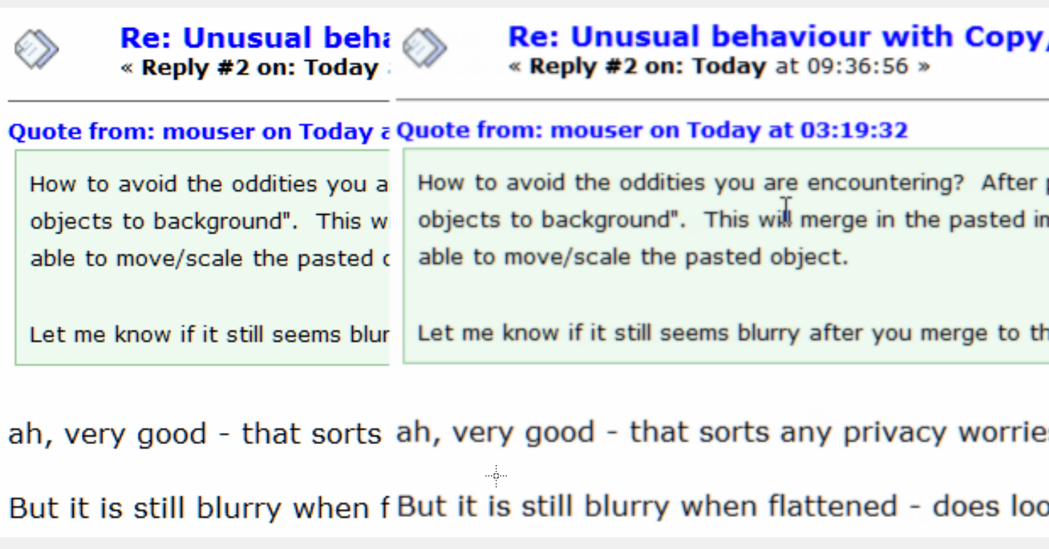

In my copy-workflow I recognized that the dropped file is inserted smaller than the original size (tested with two identical screenshots) (picture 1).

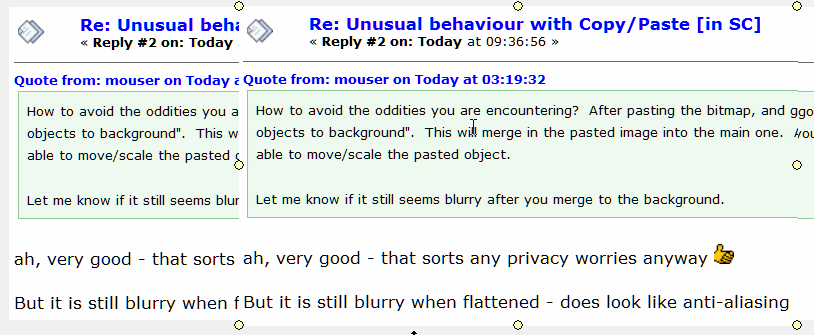

After setting size to 100% the dropped object is still sharp as the original (picture 2).

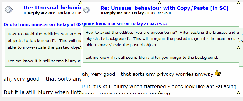

But after "flatten all objects to backround" you can see that the inserted picture is a little bit blurred (picture 3).

I too can confirm that flattening the objects makes the pasted image blurry.
