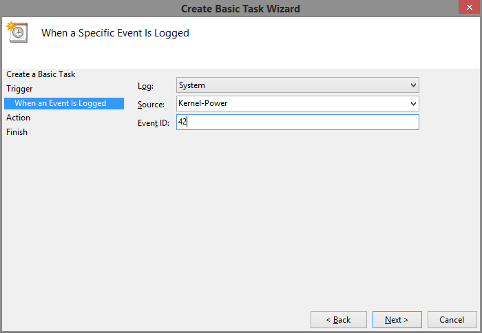

Can you not use Task Scheduler to execute a script to demap the drive when the computer goes to Sleep and/or Shutdown?
I made an EventLog filter back here for power events if you want to check the Event ID.
It would seem to be the simplest method.
You could probably use the Task Scheduler to run a script on wake up to check whether it's connected to the work LAN or not and run following mappings/commands as appropriate.
