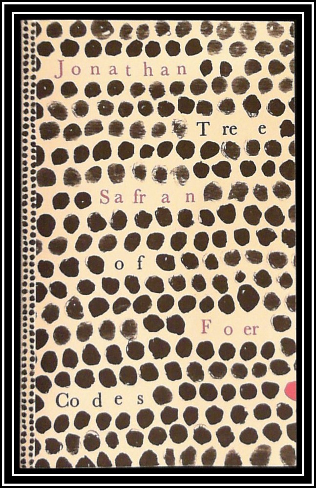

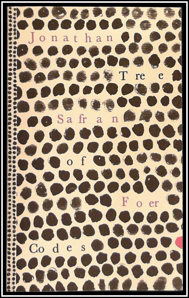

OK,
It would be great to have a 3rd Party App to be able to do more on cropping the image.  How do I get in touch with the member above you mentioned who has written a Crop App?
I did find a way to do something similar to what I mentioned about adding a border which I like using Screenshot captor.  After I crop the book cover,  I used the "Simple Boarder Around Image (Outside)" several times to get more some black around the image.  The book is on Black Velvet and so has a black background before I crop it.  The book is never completely perpendicular so that when I crop it, it always seems to have some black on some of the edges.  Adding some black boarder back by using the function above resolves this issue.  The book my seem just a bit rotated but I can keep this to an acceptable level.  After I add some black boarders back I use the "Deluxe Black Boarder Around Image".  I like the results I end up with.  I have attached a couple of pictures of a book I have done this too.  The first picture runs the Autohotkey script below once and the second picture runs it twice.
SetTitleMatchMode 2
WinActivate, Screenshot Captor
WinWaitActive,Screenshot Captor, , 2
Send {Alt Down}2{Alt Up}{Down}{Right}{Down}{Enter}
Send {Alt Down}2{Alt Up}{Down}{Right}{Down}{Down}{Down}{Down}{Enter}
This may be good enough for my purpose but it might still be nice to have more options using a 3rd parties cropping program.  The only drawback to the above  is that the script above takes just a bit to run, so may add a few seconds to the picture tacking process.  I am sure a 3rd Party cropping program would be faster.
To do the above however I need to have Autohotkeys send characters to Screenshot captor telling it to "Auto Crop".  I did not see an menu Item to do this like there is for the "Auto Rotate" function.  Is there a key sequence I could use to activate this "Auto Crop" feature or is the only way to activate it would be to click on the Auto Crop Icon?

Mouser,
One other thing the reason the all the add a little black borders takes time is that I am going through the menu and so the display flashes as I do this slowing things down substantially.  If there was a Cntr or Alt key shortcut to do this it would go much faster since it would not need to go through the display.
I believe Autohotkeys often handles this type of thing by using a "Control Send" command instead of a "Send" command.  With the "Control Send" the Window can be minimized and every thing happens in the dark (so to speak) so it is much faster since the display is not activated with each send key menu command.  However, it appears that when one Minimizes Screen Captor it does not really go into a Minimized state but into some other Mode?  I have not gotten this approach to work with Screenshot Captor.
Do you know of a way I could get around the slow down problem above of adding incremental black to the edge of the picture many times to get a larger black boarder?  What I am using presently is workable but it does add about 2 or 3 seconds to the Image Processing Time - that is with adding 22 small black boarders.  I am sure if the Menus were not flashing - ie use a Alt or Cntr shortcut instead of sending keystrokes to the Menu Items, then doing this even 22 times would be VERY fast.
