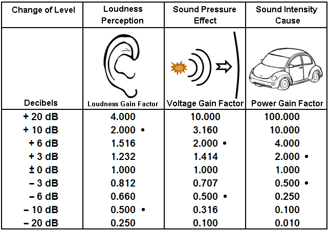

Here's a fun chart:
from here:
http://www.sengpielaudio.com/calculator-loudness.htm
I don't know what is going on there, but it looks helpful if I did!

It gets crazy because the human ear doesn't perceive loudness in a linear or strictly physical manner. Check out this article if you want to really start pulling your hair out. As one EE from MIT who was the most knowledgeable sound engineer and circuit designer I ever met told me: It's not just science, It's psychology.  :tellme:
