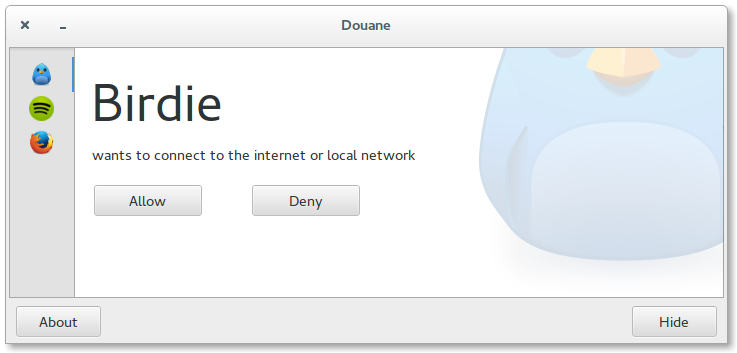

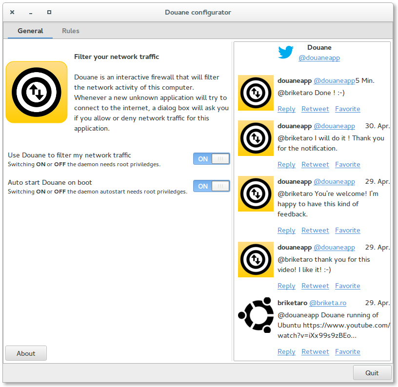

Looks like somebody coded a personal firewall (Douane) that is "application aware." First time something goes to connect to the web, it affords you the opportunity to allow or deny it. Your answer then becomes a rule that's stored for future use.
There's also a control panel that allows you to start and stop the firewall plus enable/disable/delete rules you've already created. This is very similar to how a Windows firewall called ZoneAlarm used to behave. Very convenient for a newbie user. It's also occasionally eye-opening when you see just which apps are seeking web access. And when.
Very handy IMO.

UPDATE:
Ok, I installed it on a test machine (Mint 17.1 Cinnamon) and have concluded it's NOT ready for prime-time.
Issues:
1) The installation dependencies have left out g++ as a required package. Not a problem as long as you understand the error message you'll see and know how to install g++. Many new users won't have a clue.
2) If you follow the installation steps exactly, at a certain point about half way through you are instructed to start the douane-daemon to verify it installed properly. If you do that you won't be able to complete the installation, because it will be running before the configuration utility and the GUI are installed - and it will be blocking everything. So you'll need to stop the daemon (i.e. sudo service douane stop) to get web access in order to complete installing everything else. Not a problem for a moderately experienced user. But a newbie will find their machine is now unable to get any internet access until they stop the service or (hopefully) reboot their machine. That's pretty scary situation for a new Linux user to find themselves in. Fortunately, the installation process doesn't configure the daemon to autostart on boot or it would be a total nightmare for the unsuspecting.
3)The script for installing the Ubuntu launcher for the Configurator does not work with Cinnamon. You'll need to do it manually.
Item 2 above is pretty serious IMO. But the real showstopper is Douane does not recognize Firefox. It caught Thunderbird and Dropbox just fine. But FF (v33.x) and it's cousin PaleMoon (25.1.0 x64) were ignored. No popup asking what to do. So if the douane-daemon is running you won't be able to use either browser unless you turn it off.
That was it for me.
