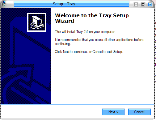

It may be on the Inno third party listing someplace..  I remember there was a free program that let you embed themes in your installer.  Pretty easy to do.  It builds a small DLL into the install exe and you call functions in it to show your installer wizard themed.  In fact the setup program for my optical Tray program still has a themed install.
