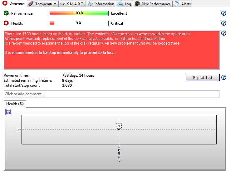

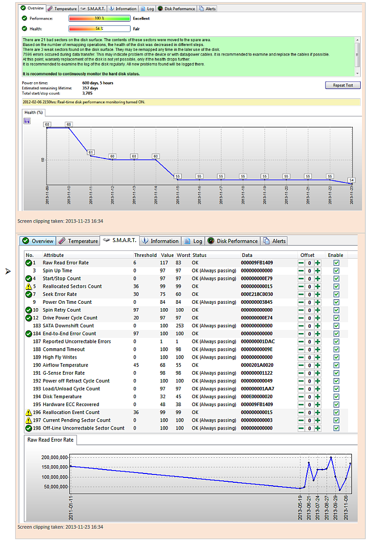

Interesting. Based on sound observations. That tallies pretty closely with what HDS (Hard Disk Sentinel) was reporting about the deteriorating state of my laptop hard drive a while back. I shall make a note of those for future reference.
This was a Seagate ST9500420AS 2½" laptop drive:
« Last Edit: November 20, 2014, 01:22 PM by IainB »

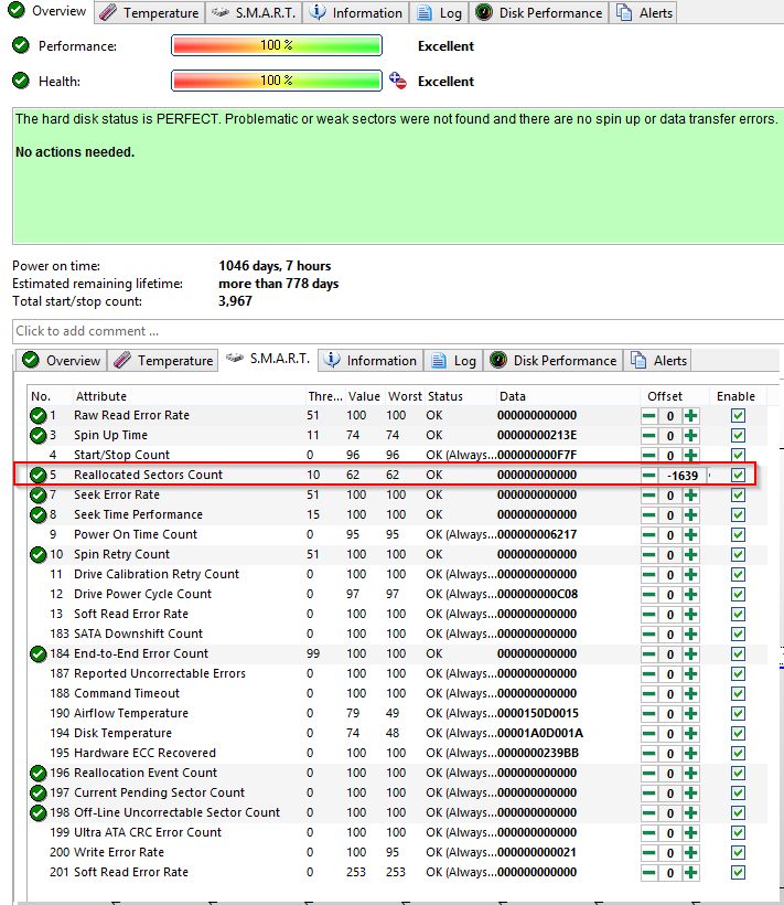

^Those stats indicate that it's still a good working HDD AFAIAC  :)
Remember this one:
Almost three years later:

Because the drive had not run out of spare sectors, and was able to remap 100% of them to spare areas.
I've salvaged quite a few 'bad' devices that way, simply overwriting them repeatedly a few times to brute force trigger the remapping sequence.

@4wd: Blimey. What did you do to get that result? Why does it have the Plus and Minus next to the 100% Health report? I've never seen that before.
Did you somehow set the offset to -1639, or did HDS do that? I haven't thrown away that "bad" drive of mine. If it still has life and is not deteriorating, then maybe I should put a new image on it?
The +/- appears when you put in an offset - which you can do next to any of the S.M.A.R.T. values.
That drive is over 5 years old and still spinning its wheels.
You can run a Low Level Format a couple of times to see if the sectors get remapped, (what I usually do when a HDD starts getting flakey), or use something like MHDD.  Fill up the HDD with big files a few times, at some point it may trigger the remap if the sector gets hit enough times and produces errors.
