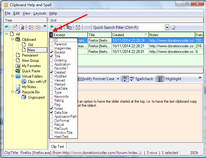

Does this help?  Note the direction of the arrow in "Created".
Forgot to add; you may need to choose which columns you see by clicking on the very small icon below:

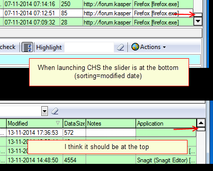

« Reply #4 on: November 13, 2014, 05:38 PM »
When I launch CHS the slider is at the bottom, the oldest clip, whereas I think it should be at the top.
Like this

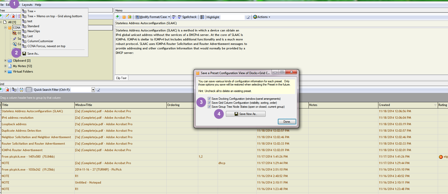

Scarily, I'm feeling quite blond right now, trying to attach an image.
Here's how to do it:
► Set up your layout however you want it.
   In your case, you would have the "Created" column sorted with the little arrow pointing down.
   MAKE SURE this is the case, in every folder you care about!
► Go to Layouts (Top left, part of the menu)
► Go to bottom of the drop down and pick "Save as..."
► A small window will pop up - it allows you to save certain features of your new layout.
   Live on the edge like a true madman and check all 3 boxes.
► In the small box, there's a button that says "Save Now As...."
   Click it.
   If you didn't terminate the human race by clicking it, then go ahead and name it.
   The file manager will close and you'll be back, staring at the little open box.
► Dismiss it like you do your lowly servants, by clicking the "Done" button.
And that, sir, is your solution. :)

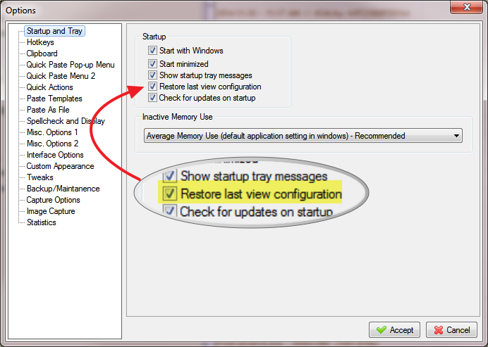

« Reply #12 on: November 21, 2014, 12:53 AM »
Yup and Yuppers!
The first issue gets resolved here:
