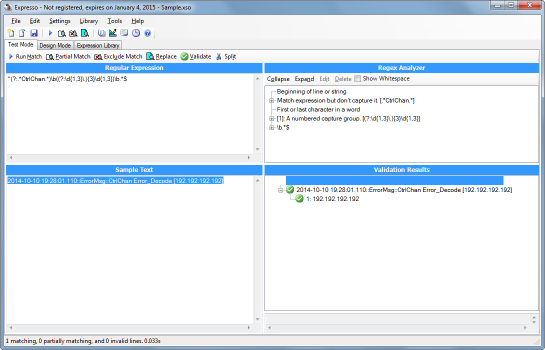

This works, but you must specify that the search is multiline in order for the ^ and $ to operate properly:
^.+CtrlChan .+[^0-9]([1-9][0-9]{0,2}\.[1-9][0-9]{0,2}\.[1-9][0-9]{0,2}\.[1-9][0-9]{0,2}).+$
Here's the result in Expresso:
Re: Regexp help
« Reply #6 on: November 05, 2014, 02:25 AM »
And here's the analysis to help explain what's happening in there:
Re: Regexp help
« Reply #7 on: November 05, 2014, 02:33 AM »
With a little help from here.
NOTE: It doesn't check if the IP is from a valid range like @Ren's but on the other hand it won't miss any if the IP is invalid.
