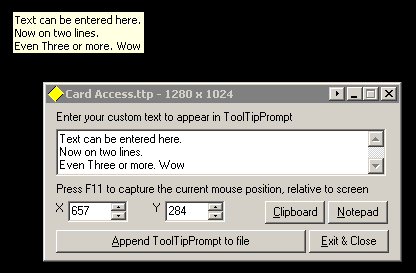

Have learnt a lot of AHK in the last 24hrs.
Update-
jgpaiva sent me a Tooltipcreator (thanks) and the modified version can be found below. Feedback welcome.
ToolTipCreator
will create a file with the TTP extension in the same directory it is installed.
use the F11 key to capture the mouse position
enter text to appear in ToolTip
Test ToolTip - will display tooltip on screen
Save ToolTipPrompt to file - will append x,y,text to the end of file
You can still modify the X , Y position and test before saving line.
This will create a file that can still be modified in a text editor. But it gives you a good headstart.

My first useful script  :D, I'm addicted. (and learning mountains)
TooltipCreator - now with clipboard button
Use the clipboard button when editing a TTP file in a text editor.
Copies x,y,text string to windows clipboard.

I have just about reached my limit again with AHK,
After a significant breakthrough thanks to jgpaiva, I have got this to where it fullfills my own needs.
New additions
ToolTipCreator
- live display/update of tooltip as creating
- Multi Line tooltips
- Current Screen Res in Titlebar
- Open the TTP file in Notepad for extra editing
- X and Y nudge spinners for precise positioning
ToolTipPrompt
- Icon for exe
What I would appreciate is if anyone would suggest improvements to the AHK code. (email)
Or if there are suggestions to improve the usefullness...post here. (and bugs)
Thanks
dB
