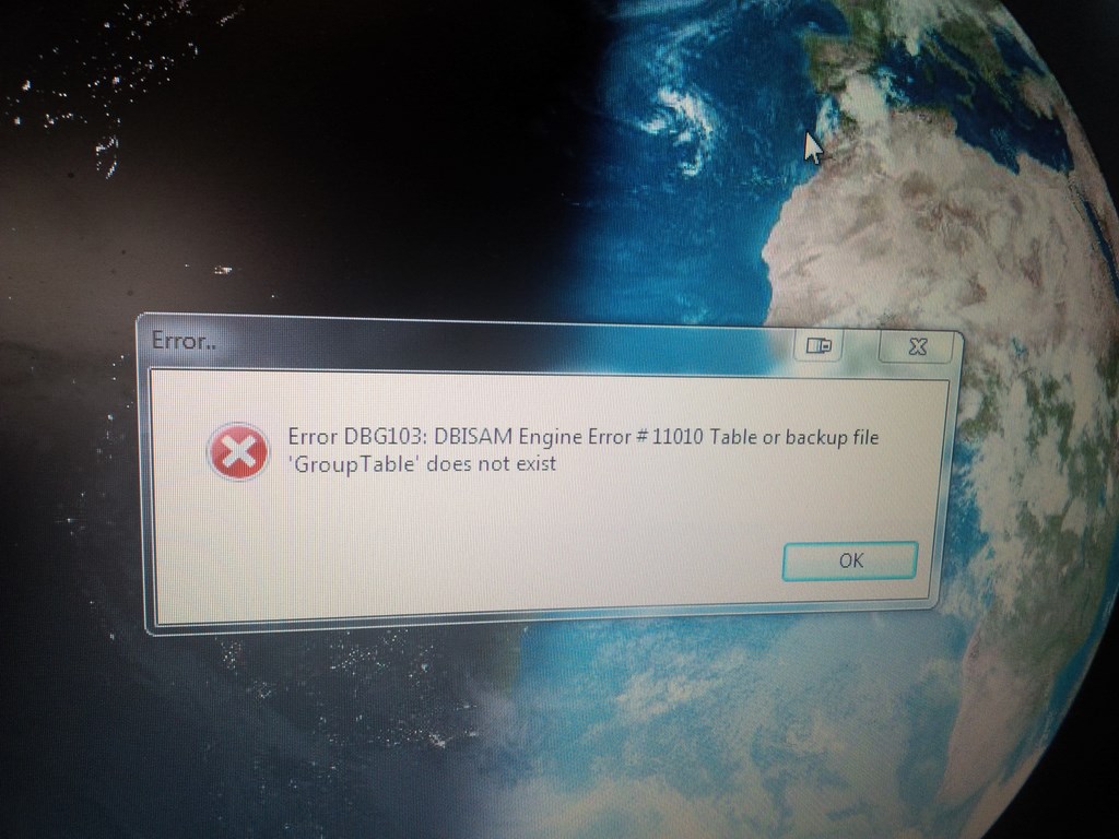

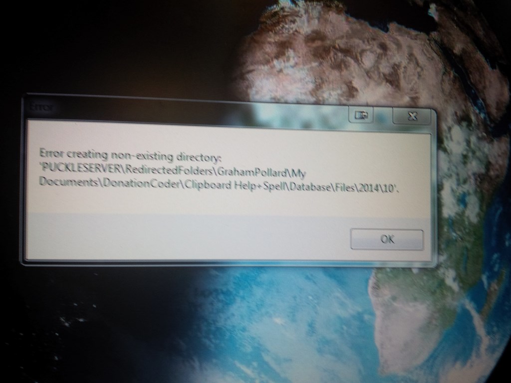

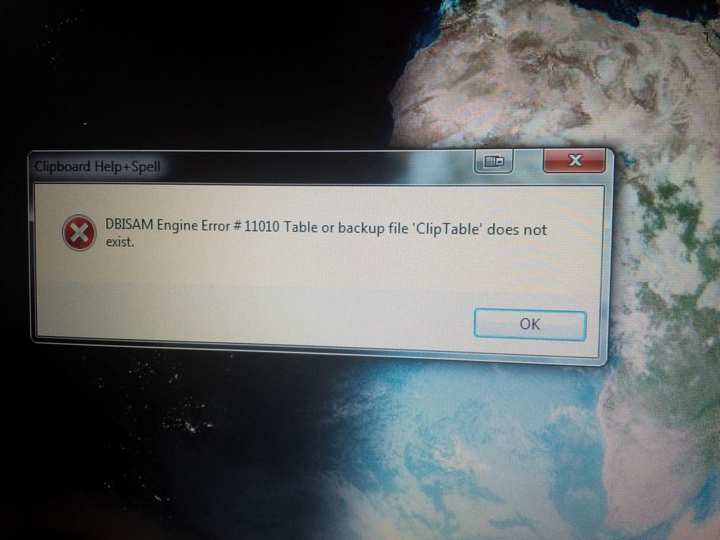

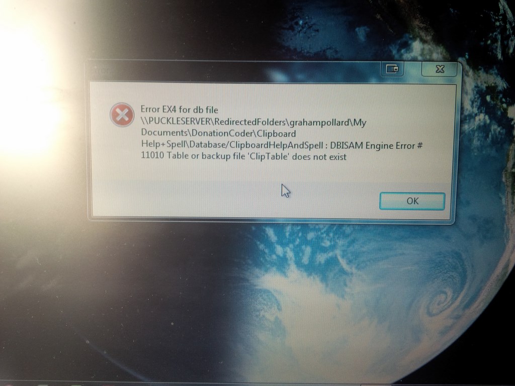

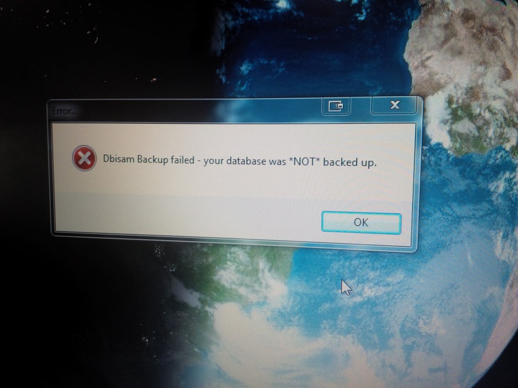

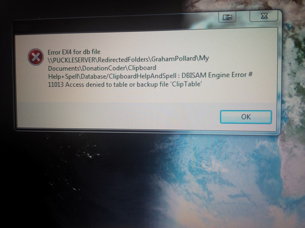

I have only had CHS installed for a few days and it gave errors quite a few times regarding the attached screenshots. But I've persevered with it, uninstalling and reinstalling a few times. The main thing that seemed to resolve it was manually creating the folders in the relevant directories (it wasn't creating some of them itself - I also had the same problem with Screenshot Captor).

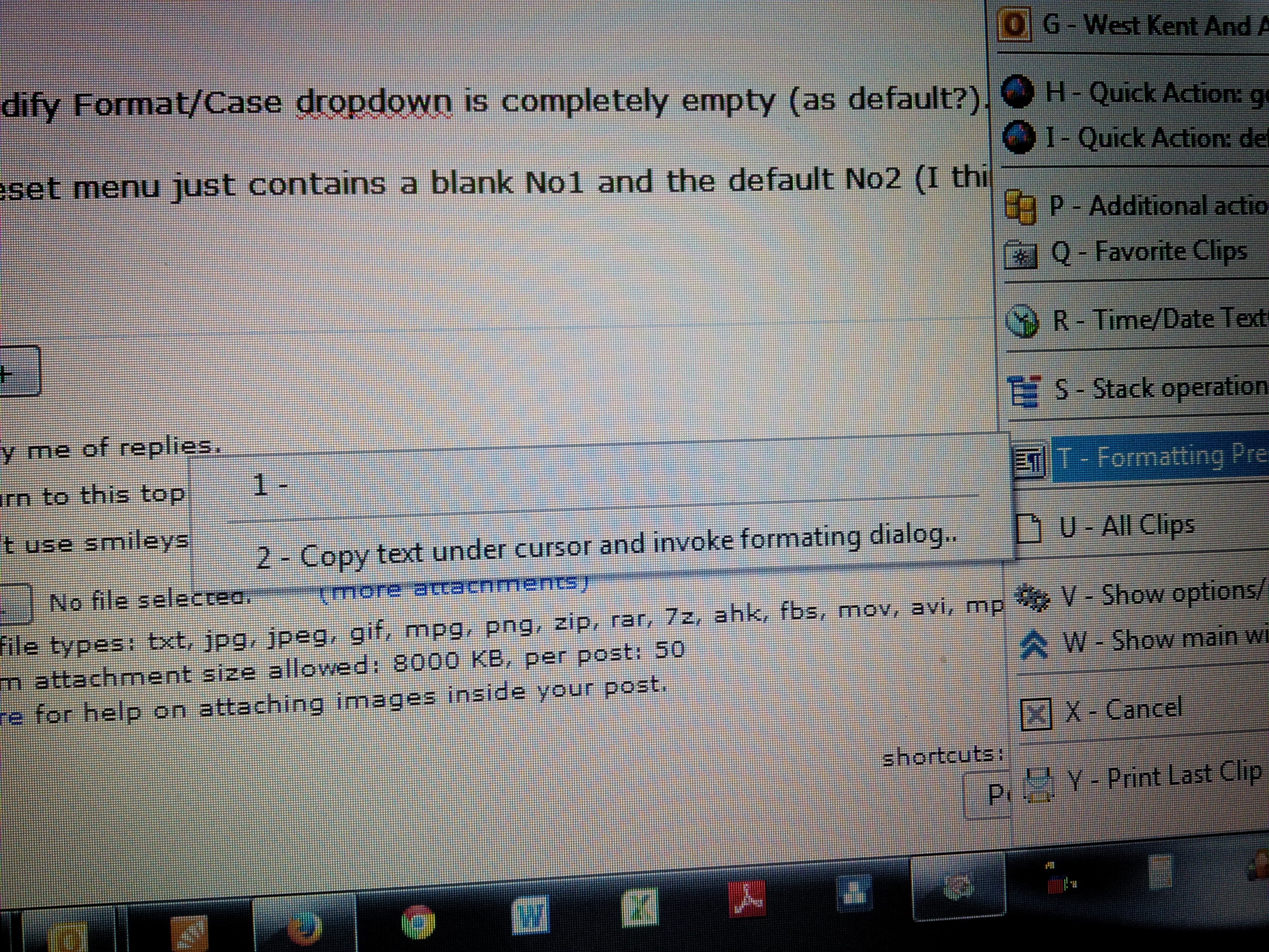

The preset menu just contains a blank No1 and the default No2 (I think those two were there as the original defaults?). Screenshot attached.

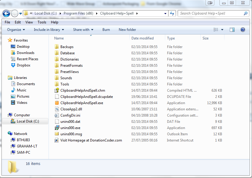

The only snag - I can't find a file called ConfigDir_Sample - screenshot of folder attached.
Can you please help me from here?
Thank you.
Re: Presets not saved - CHS
« Reply #9 on: October 02, 2014, 07:02 PM »
ah my mistake.  so just edit ConfigDir.ini no need to rename it.
