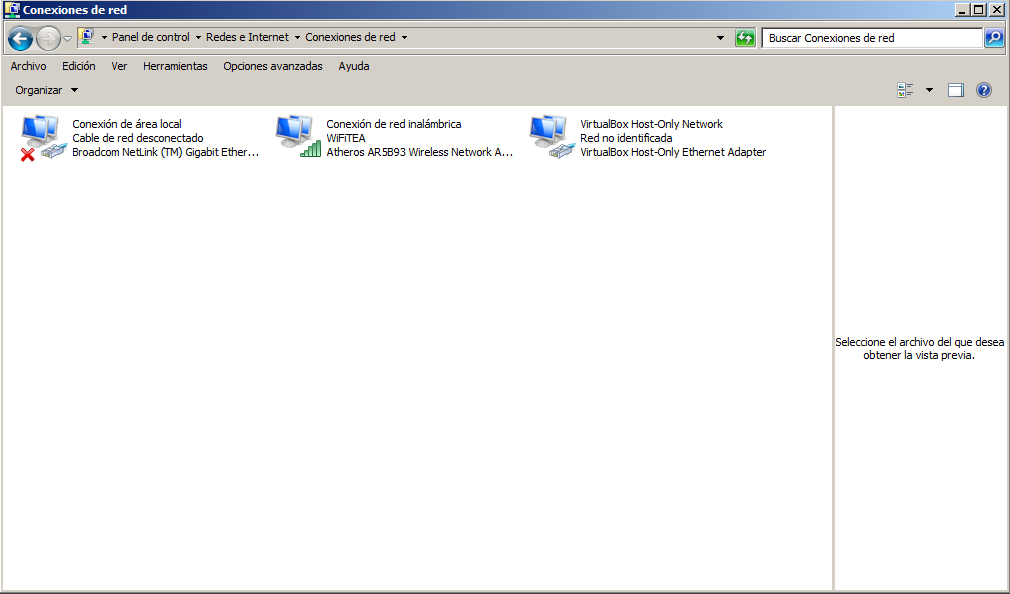

I am trying everything but only get disabled the virtualbox adapter for VM.
This is my script :
rem netsh interface set interface name="Local Area Connection" disable
rem netsh interface set interface name="Local Area Connection" enable
rem Conexión de red inalámbrica
rem Conexión de área local
rem VirtualBox Host-Only Network
netsh interface set interface name="VirtualBox Host-Only Network" disable
netsh interface set interface name="Atheros AR5B93 Wireless Network Adapter" disable

rem solamente se desactivó la de virtualbox , el resto no y me pregunto si tienen que ver los asuntos o si se les puede dar otro nombre en anglosajón
rem creo que tiene que ver con sus nombres reales
rem mirando en el administrador de dispositivos los obtengo
rem Atheros AR5B93 Wireless Network Adapter acer
rem Broadcom NetLink (TM) Gigabit Ethernet acer
rem vamos a probarlo

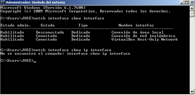

As per your other thread's post here asking how to get the adapter names, you can use the following commands:
netsh interface show interface
netsh interface show ip interface
Example output:
Spoiler (click to show/hide)
skwire@jody-pc ~
$ netsh int show int
Admin State    State          Type             Interface Name
Enabled        Connected      Dedicated        VMware Network Adapter VMnet1
Enabled        Connected      Dedicated        VMware Network Adapter VMnet8
Enabled        Connected      Dedicated        Local Area Connection
Enabled        Connected      Dedicated        VirtualBox Host-Only Network
Enabled        Disconnected   Dedicated        Local Area Connection 2
skwire@jody-pc ~
$ netsh int ip show int
Idx     Met         MTU          State                Name
  1          50  4294967295  connected     Loopback Pseudo-Interface 1
11          10        9202  connected     Local Area Connection
20          20        1500  connected     VMware Network Adapter VMnet1
21          20        1500  connected     VMware Network Adapter VMnet8
16           1        1400  disconnected  Local Area Connection* 11
19          20        1500  connected     VirtualBox Host-Only Network
24          30        1500  disconnected  Local Area Connection 2
