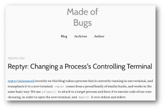

reptyr - A tool for "re-ptying" programs.
reptyr is a utility for taking an existing running program and attaching it to a new terminal. Started a long-running process over ssh, but have to leave and don't want to interrupt it? Just start a screen, use reptyr to grab it, and then kill the ssh session and head on home.
