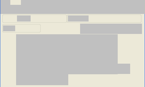

This is just a 1st attempt using only the Calculator to see if we are on the right track,
I have not decided the layout for saving to different windows, or if and how settings are saved to a ini.
So calculator will be the test for now.
The limitations
- with AHK splashimage is that you have only ten covers to work with . but it seems very effective.
- to destroy the wincovers when a different window is active, I minimized the Calculator window to the taskbar.
- it does not stop Shortcut Keys.
