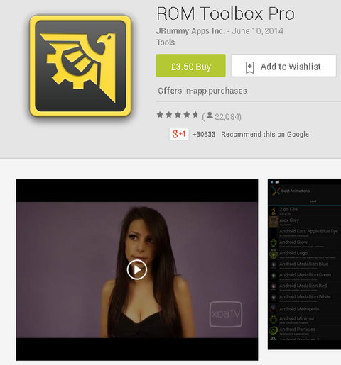

A question: Even after paying for ROM Toolbox Pro, you're still prompted to buy more within the program?
BTW, I know why you guys really bought it ;D

« Reply #10 on: July 15, 2014, 01:54 PM »
It has a 'donate' button which will charge you $5 from Google Play - the "Offers in-app purchases" you see on the Play store page is probably due to that.
I don't recall running into any required in-app purchase situations.  However, there are several parts of the app I haven't used (ROM management, font installation, boot animation).

I went ahead an bought titanium backup. I'm going to pass on Rom Toolbox though. I use multirom with a modified TWRP recovery for my roms, and I don't have a need to change fonts. I also just manually change my boot animation, because I rarely change it anyways. I was tempted to buy Rom Toolbox tho when I saw SassiBob's video was on the page.
