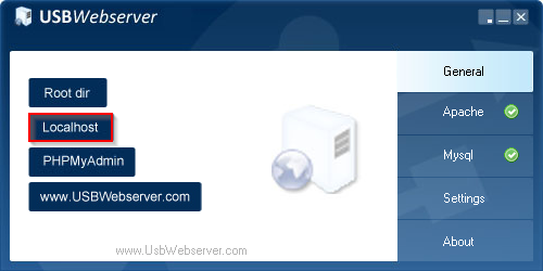

Download this: USBWebserver8.6 + ownCloud ~49MB (~160MB when extracted)  It's on my ownCloud server.

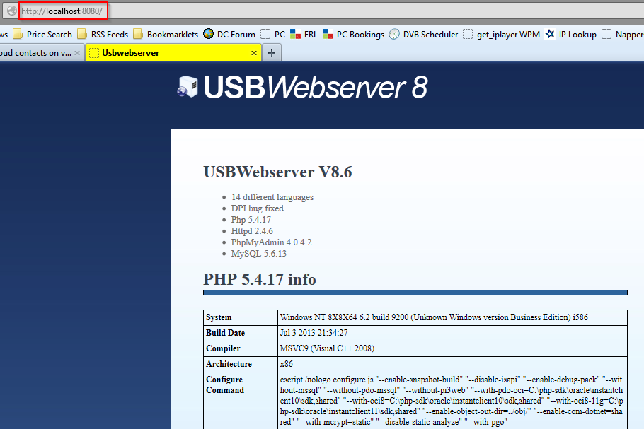

Extract to a flash drive, (make it a fast one), or an empty folder, run usbwebserver.exe, when the interface comes up, choose your language, and then click the Localhost button.
It will open the home page of USBWebserver in your browser, eg.

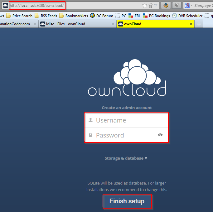

Change the address adding owncloud to the end, hit Enter, the ownCloud setup page will open:
Fill in a username and password for the Administrator,  then click the Finish Setup button.

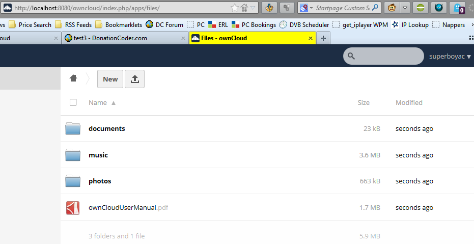

All being well, you'll end up with this:

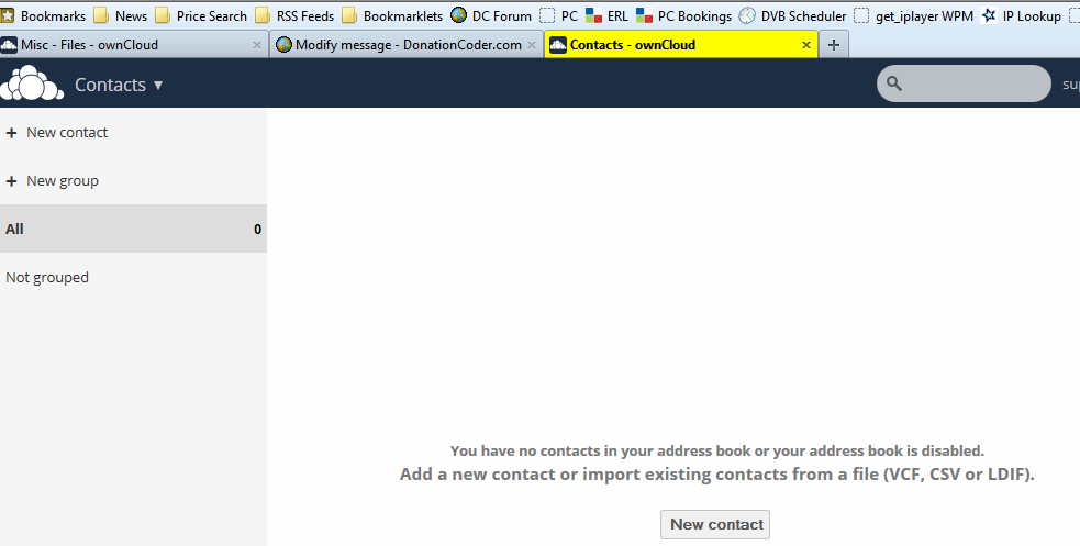

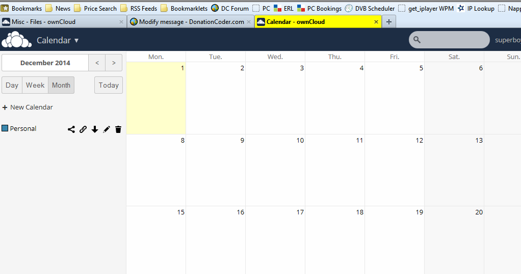

Here's Contacts and Calendar:
