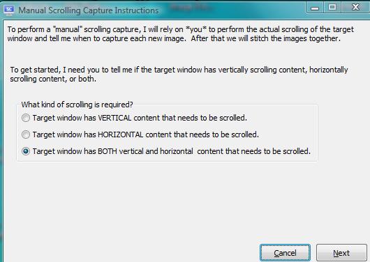

If I click on Option 3 (above), the I get a new window with two buttons near the top.
Button 2 is Let Me Manually Scroll the Window.
I am presented with  dialog box titled, Manual Scrolling Capture Instructions.  (see 2 attachments)
Maybe we are now on the same page (?).

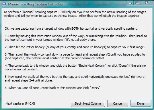

An instruction dialog box It tells me to Manual Scroll and take successive screen snapshots which it will stitch together.
This didn't work well...the stitching had lines of texts missing (cut-off horizontally, the letters weren't capture to full height).
And the picture was  captured to fit on a single page, so that it would small (unreadable) when printed.

Window pops-up : What kind of Scrolling is Required ?
  • I select the first bullet (Vertical scrolling).
  • Click Next
A window pops-up with the screen capture Instructions in it.
How can I select what to capture when the red box has disappeared ?

Select Item 3: Begin a Scrolling Window Capture on this Object.
Select Item 2: Let me Manually Scroll the Window
Click top bullet (if needed): Target Window with Vertical Content
Click Next
Minimize or move dialog box outside the window to be captured.
Press fn+Alt+PrtScr to capture the first screen
Press the Page Down button on your keyboard to scroll down an entire page.
Press fn+Alt+PrtScr to capture the next screen
Repeat the Capture/Scroll process until you capture all of the screens that you want.
Click Done in the Dialog box that you had Minimized/Moved.
Press Start Here: Guess Margins
Press Then: Guess Overlaps Given Margins
Press 100% then Preview now to view the capture in the small window pane area.
Press OK, Save built image button.

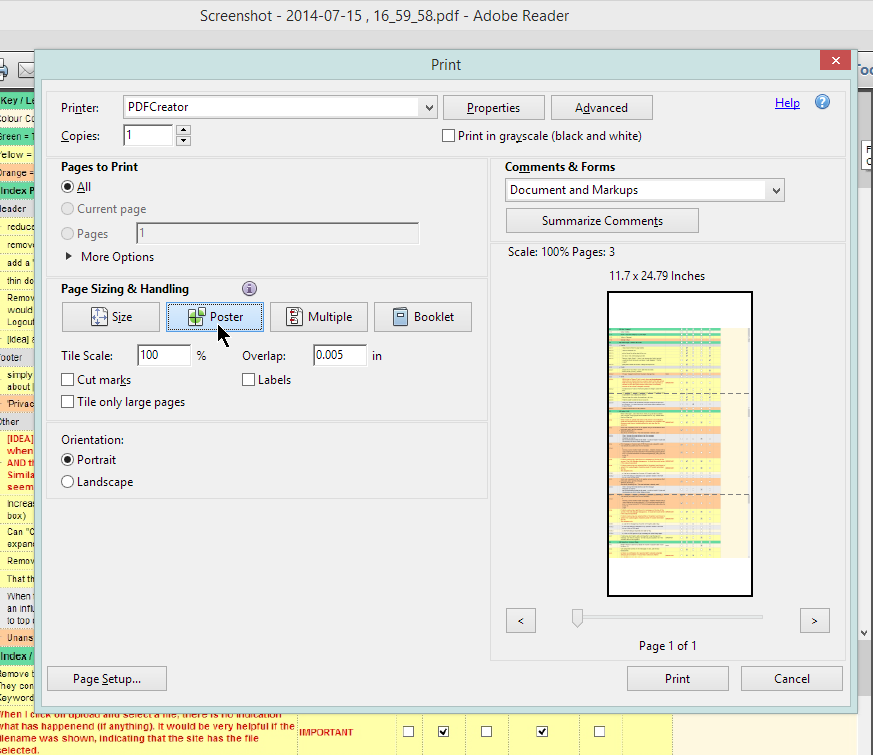

You probably have an A4 printer - if the image is bigger than A4, it cannot print at full size on your printer - so it offers to print at fit-to-page, or it offers to print a selection/detail. When printing a detail, it will select the centre part of the image (that's why it picks page 2 of 3 pages) unfortunately this cannot by changed in Adobe Reader.
I'm on a Windows 8 machine, with Adobe Reader X1 (11)
Here's the print dialogue I see:
in this version, there is an option to print 'Poster' - this will print the image at 100% and break it up in as many pages as necessary. Do you have that on your version?

I have Adobe Reader X (10.1.10), and it does have the Poster Print Option.
I tried that, and it appears to have worked !
It prints the captured picture in Landscape mode, but at full-size...so this is good.

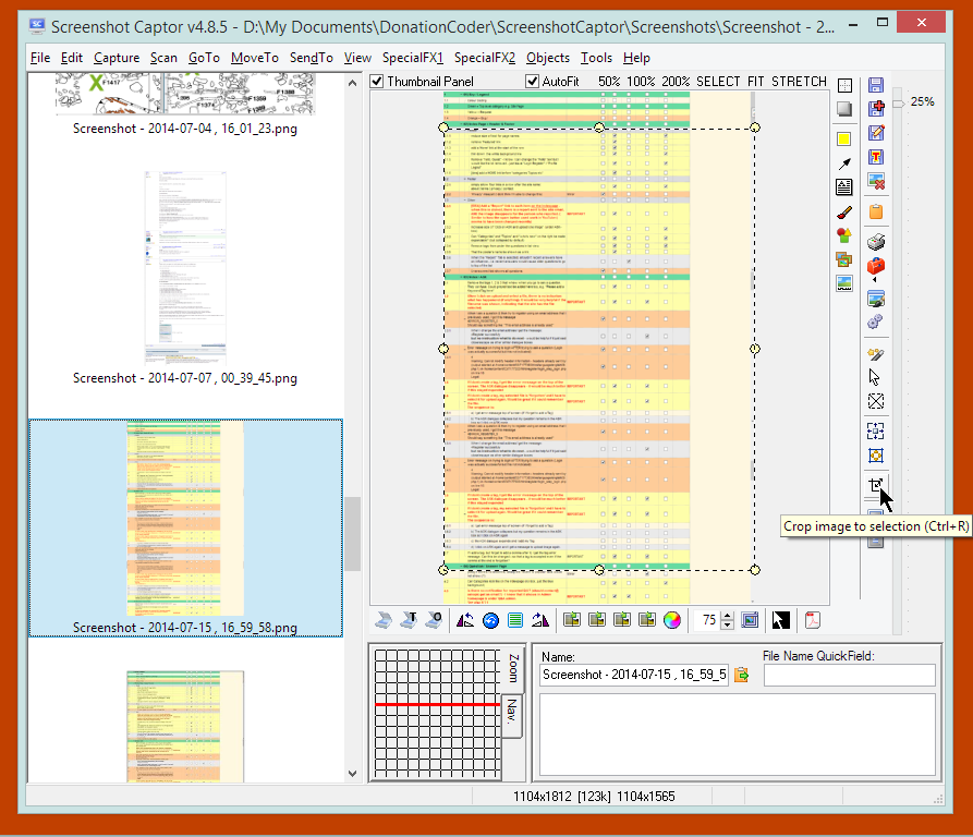

The cropping would be done afterwards:
  • Open the main SC window after you have saved your capture
  • If your image is not already selected, select it in the thumbnail panel on the left
  • Click and drag in the image to select an area you want to keep
  • Click on the crop button on the toolbar on the right (see mouse pointer below)

That worked ... thanks !

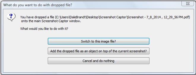

Can you edit a pdf file with SC ?
I tried editing a pdf file via Dragging & Dropping it onto the edit window.
I received this dialog box (jpg file attached), but I received no picture to edit...just a blank edit area.
Thank you

1) you cannot edit a PDF unless you give Adobe about 500 dollars for the privilege :) even then it's often problematic - the format was designed as a final product that would (hopefully) look the same on every machine.

Hi:
Thanks for your reply ... but your suggestion did not work.
The Dialog Box that pops-up over-rides control of SC functionality...I can't do anything.
Would I need to do I new Capture of the entire window and then crop it to get just the Dialog Box,
or should I be able to just crop the current screen in which the Dialog Box is appears ?
Either way, I can't ... I have no control of  SC.
I have to make a selection which the closes the Dialog Box in order to regain control of SC.
