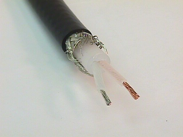

Some old 3COMs used to have special matrix-type ports and cables to link the backbones of multiple hubs and switches together. That gave them better throughput between the switches than running a standard crossover cable because the network ports were mostly just 10Mbs on the boxes that had that feature. We're talking late 80s/ early 90s vintage on those. I don't recall seeing any with coax connectors though.
[attachthumb=#]     [attachthumb=#]
I'm guessing that was probably for twinax cables - which are shielded twisted pair although they look very similar to coax. IBM was big on that type of wiring for their ARCNET network topology. Their 52xx series terminals (usually connected to a System36 or System38 minicomputer) all used twinax cables. Early Ethernet did too IIRC.
