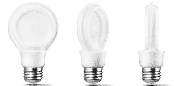

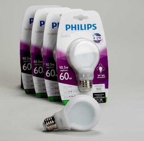

I just picked up a few of those lollipop-shaped Phillips LED "bulbs" from Home Depot. On sale for $3 and change.
I have one in the ceiling light over the kitchen sink. It looks nice and doesn't seem to throw any heat.
Don't know what the base is doing temp-wise. If I ever get my IR thermometer back I'll have to check it. The CFL lamp that was in there has a discolored base from the heat its ballast generated.

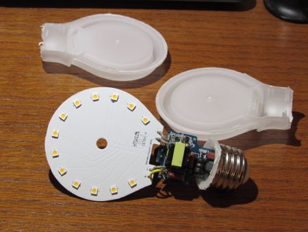

Also found this shot of the inside of one of these bulbs.
Which is great because I was very tempted to crack one open just to see what was inside. $3 saved! :Thmbsup:

Update: it's been in for a few hours now and it's warm. If I put my fingers on the ring around the 4 o'clock mark, I can keep them there about 3 seconds before I have to move them. It's definitely hot enough to burn.
Oh well! So much for the heat reduction. The CFLs are definitely running cooler. The lamp base is equally hot - but at least the CFL tube was touchable. Not so the LED ring.  :(
