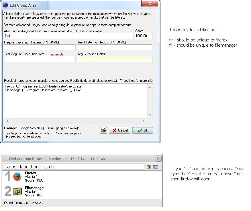

Ah ... this looks much better. Yesterday after the testing i actually started doubting myself that i had seen it working in the first place.   ;)
This modified version does it correct now.
This brings up another question for me:
Is there any way i can limit my searchresults further to a specific alias group for example with the options that are currently there?
(Question came up after i accidently ran one of the other included aliases)
I could think of a dirty workaround by naming my aliases with a prefix like e.g. "(ax)" so
the alias firefox would be named "(ax)firefox", an alias "filemanager" would be named "(ax)filemanager" and so on.
Then i would define the hotkey as "+alias +launchone (ax)" and could get what i want but i doesn´t really look too good.
Could i filter against the text "(ax)" for example in which case i could add it at the end of every alias i use for autoexecution?
[attachthumb=#1]

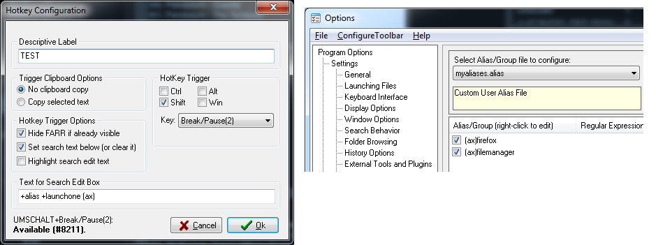

Then there are the other options that would create work ...
- extend the +alias parameter to allow naming which alias lists to search through
[attachthumb=#2]
However this would get clumpsy fast if a user would want to name more then one list of aliases

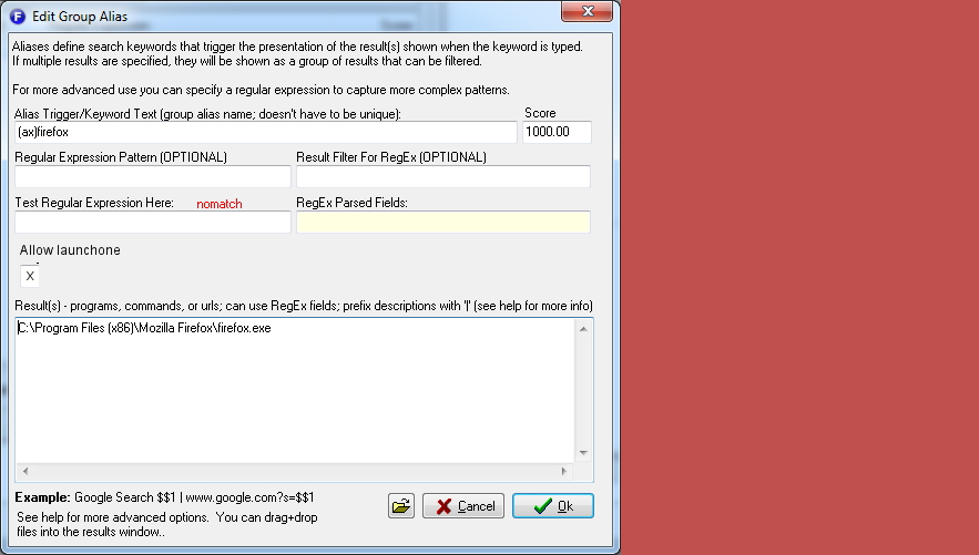

Another option would be to actually make this accessible per alias
[attachthumb=#3]
However i guess i am just to blind to find a way with the tools already at my hand.

This last suggestion seems to work for me. I tested it before i left and there was an issue which i don´t remember just now.
One thing i am not sure about is: it does only execute after the second letter of the unique match for some reason.
I will attach the description as a screenshot
Re: [Suggestion] Secondary mode with execute on first unique match
« Reply #20 on: June 15, 2014, 12:58 PM »
You've got the default non-contiguous matching enabled, so "Filemanager" is matching against fir.
You could turn off non-contiguous matching if you wanted to stop that.
From your example it seems like i should probably add an additional option for disabling non-contiguous matching just for aliases -- since that seems like something people might want to be able to do.

Thanks. Thats does it..
However now i found what feels wrong for me before i left.
If i only type m in the above example it will execute the filemanager. I guess thats because m is only present in that word Filemanager.
However if i press o which is only present in firefox it does nothing. So that explanation doesn´t really hold up.
Actually i don´t want that behavior anyway. Can i force matching to start at character 1? Because otherwise typos at letter one might fire something i don´t want at all.
This gets more unlikely if you mistype at a later character so thats not a concern anymore.
I see there is "Leftmost Match Bonus" in the manual. I guess i am looking for something like a "Leftmost not match penalty" i could set like -10000.   ;)
