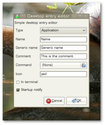

So, I've used this for quite some time now, and even squawked about it here and there, but I think it deserves a proper Webfind post.
Display graphical dialogs from shell scripts or command line.
Yad (yet another dialog) is a fork of Zenity with many improvements, such as custom buttons, additional dialogs, pop-up menu in notification icon and more.
Downloads here: http://sourceforge.net/projects/yad-dialog/
Code for above example from the Wiki:
Code
yad --title='Desktop entry editor' --text='Simple desktop entry editor' --form --field='Type:CB' --field='Name' --field='Generic name' --field='Comment' --field='Command:FL' --field='Icon' --field='In terminal:CHK' --field='Startup notify:CHK' 'Application!URI' 'Name' 'Generic name' 'This is the comment' '/usr/bin/yad' 'yad' FALSE TRUE
The Google code site has a lot of example code and a Wiki, whereas the Sourceforge site mainly hosts downloads.
It really is more than just a fork of Zenity, as it has enough flexibility to build basic to moderately-complex dialog-based GUIs for many common command-line functions.  Most of the instructions are pretty intuitive, with a few things here and there that don't seem consistent ('--rest' to read arguments from a text file?) and prepare yourself for a little pain if you need to make something requiring a tray icon...
Other than that, it's truly great.  My applause to Ananasik (Yad lead coder) and all those who have contributed.

The run dialog?  Check out the tweaks I posted about that:
http://sourceforge.net/p/yad-dialog/wiki/Examples/?limit=25&page=2#7516
