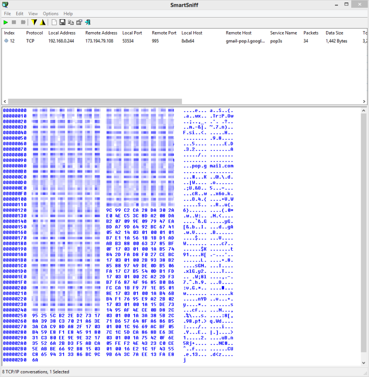

Maybe start off with Nirsoft SmartSniff ?
Since POP3 is a text protocol, it might be a little easier to get running and understand compared to WireShark.
Just had a thought, if your email server uses TLS/SSL, (eg. Google), then you'll get very little in the way of human readable data through packet capture.
eg. Here's a packet capture from GMail:
Randomised munging instigated by me :)
« Last Edit: March 10, 2014, 01:43 AM by 4wd »
