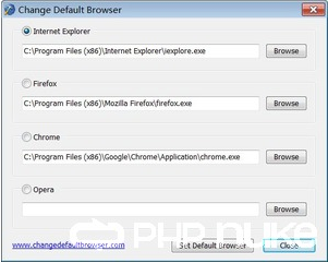

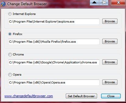

Looking working this :
Change Default Browser 1.0
Contro
  • Posts: 3,947
Re: Change default browser script
« Reply #8 on: February 01, 2014, 05:36 PM »
I have installed from
http://www.changedefaultbrowser.com/
Recognises the browsers i have installed. But not the portables ones.
And only four browsers predefined obvously
Contro
  • Posts: 3,947
« Reply #9 on: February 01, 2014, 05:37 PM »
Nevertheless with this script we can't automate the change. Only make faster the change.
:P
