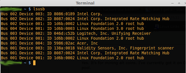

Most likely a timing issue during boot. Something takes too long to respond so Ubu just sails right on by.
Run lsusb and see what Ubu reports for USB devices. You'll see something like this:
