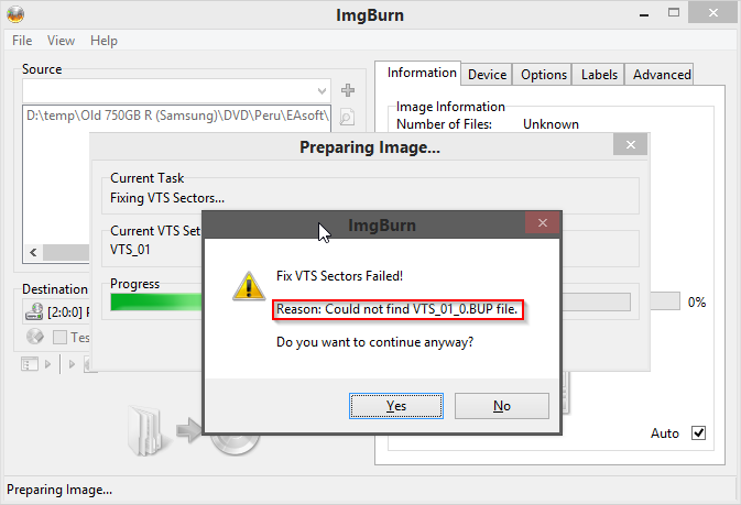

Does VIDEO_TS contain all the standard files, (.BUP, .IFO, .VOB) ?
Also, try ImgBurn, put it in Build Mode and just drop the folder containing the VIDEO_TS onto the interface.  It will change to the correct filesystem and then check to see if the necessary files are there - it will tell you if one is missing.

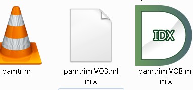

no they dont contain the files you suggest seems solveigmm produces a vob_ts file and a file called vts_01_1.vobmlmix I will try imageburn  thanks

Can you attach a list of the folder content it creates?

Hi I have added it as an attachment hope it works

Just tried SolviegMM Video Splitter and in the originating VIDEO_TS you end up with the *.mlmix, (name depends on the VOB filename).
When you press the Split button, you're asked where to save the new "chopped" output file, (which defaults to MPEG2 TS format in a VOB), and it'll be called, for example, VTS_06_7_0001.VOB.
You'd then need to rename this to the same as the originating filename and substitute it back into the existing DVD structure, (and hope the navigation still worked correctly), or reauthor a new DVD using it as the source video.

Ok Thanks for that I will try it , I have been putting the output into a separate folder thus that might be the problem .
