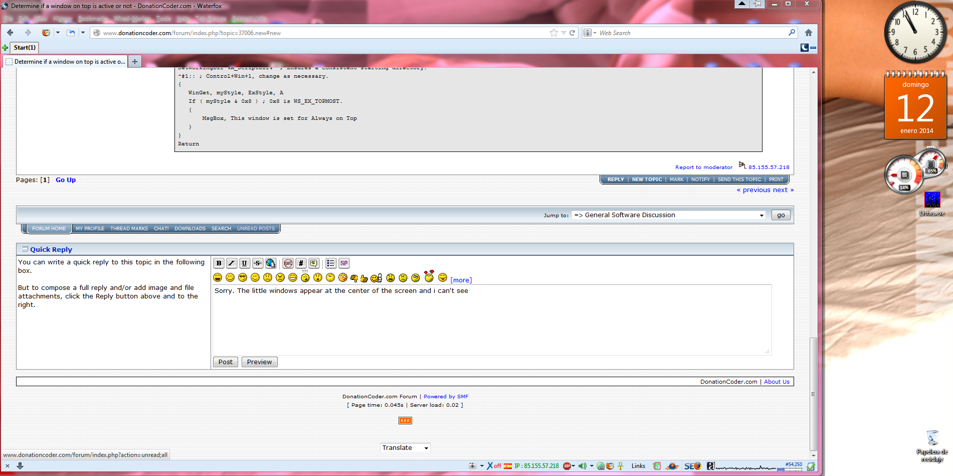

Sorry. The little windows appear at the center of the screen and i can't see.
I usually use this max-max size as appear in the screenshot....
and the little window don't indicate the window on top.
Specially if is minimized.
