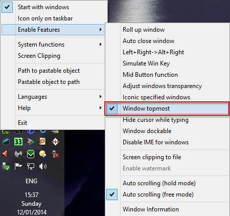

DeskAngel
Right-click the titlebar of any window to enable/disable topmost function.

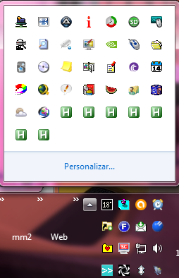

Mmmmmm. I observ another problema before trying to change the icon.
I have so many autohotkey standard residents with the H icon that usually don't are in the icon tray .

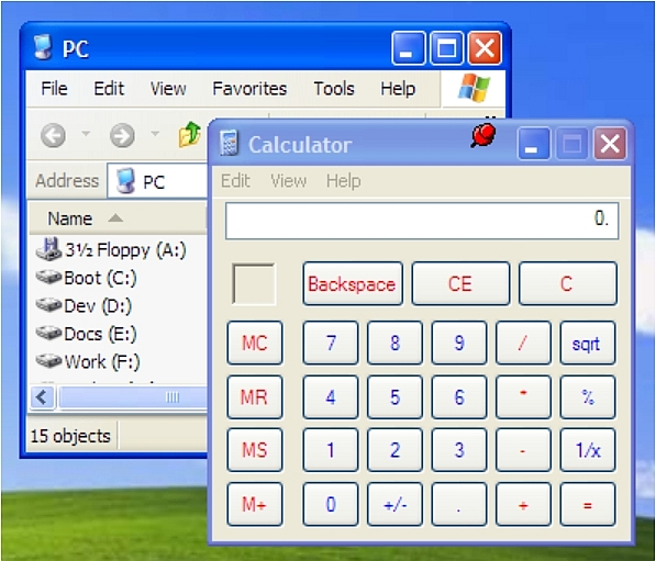

Just out of interest, and for information, the proggy from ZD-Net that I was thinking of (see above in thread) was DeskPins. I had uninstalled it a while back and put it in the "Obsolete" archive, as it did not seem to run on dual CPUs under XP.
EDIT 2014-01-15 0539hrs: Here's the program and Help etc. (freely distributable per licence) -  DeskPins v1.30.zip
Here's a screenshot:
