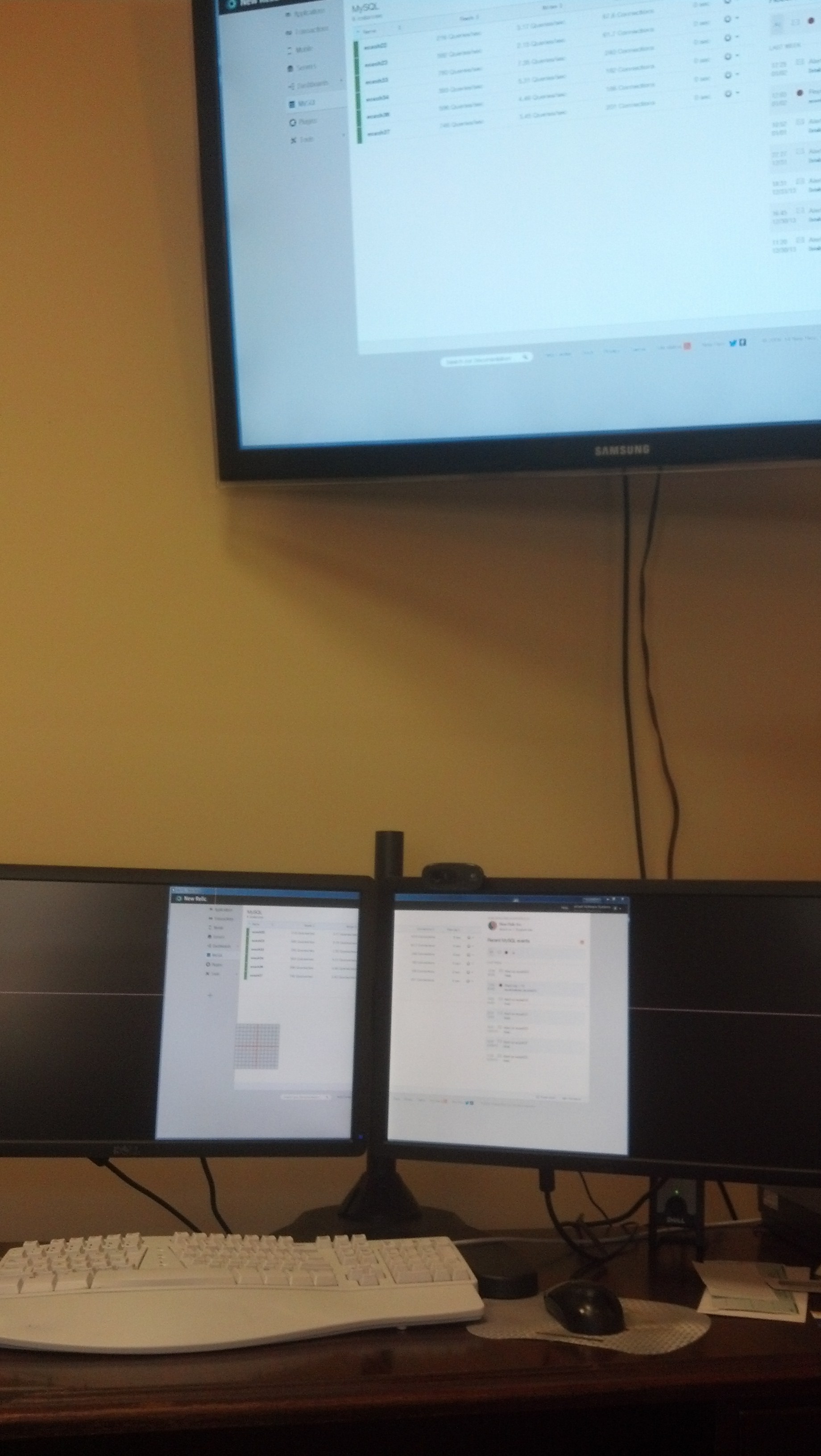

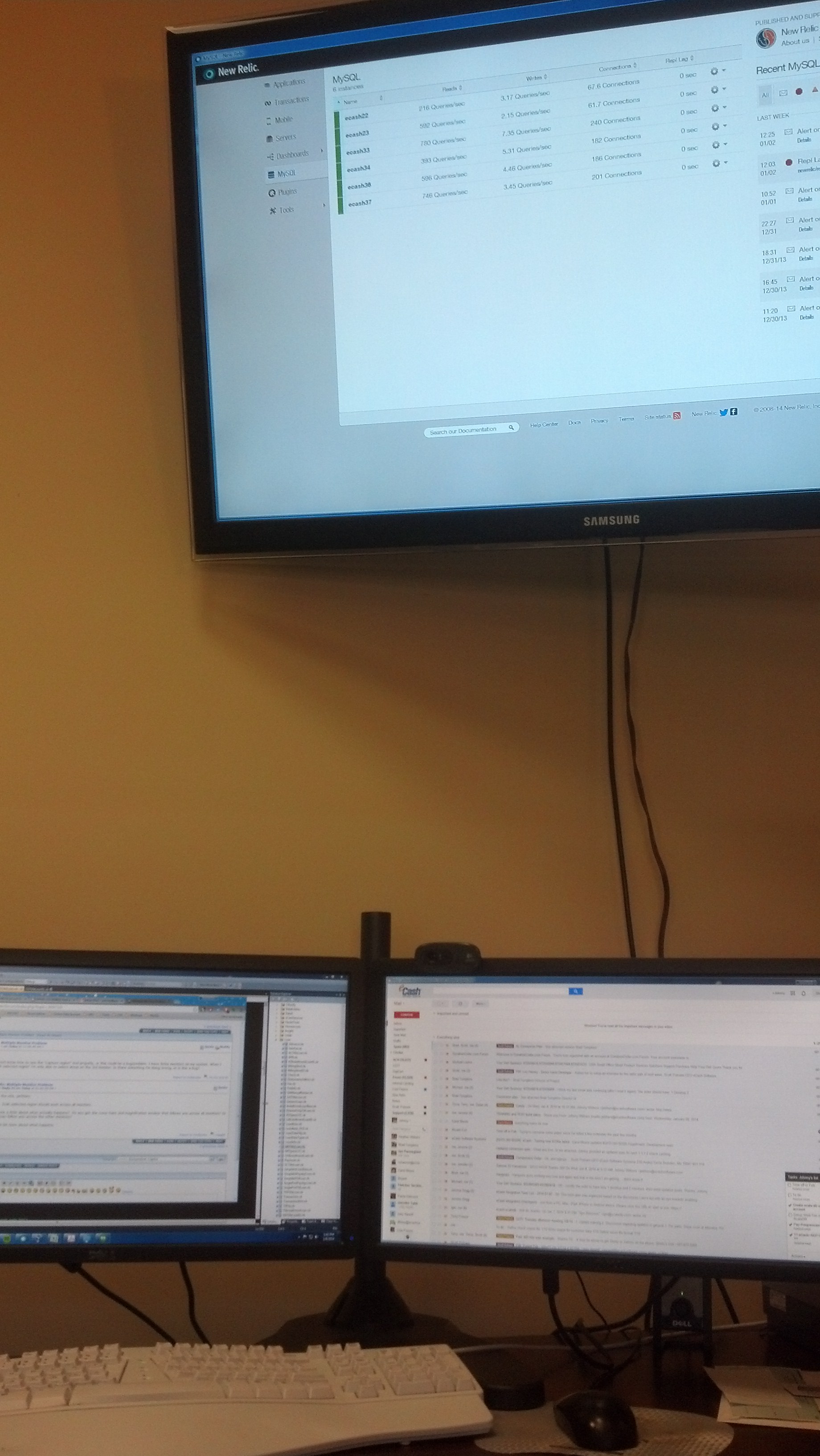

It's hard to explain, and I cant figure out how to take a screen capture of what my screens look like while trying to take a screen capture, so I took a picture of my monitors before grabbing a region and during the grab region selection.
IMG_20140108_134418_413.jpg is before
IMG_20140108_134451_441.jpg is after
For some reason the image from my third monitor (the TV up top) shifts down to the lower 2 screens and I can only select regions inside this area.

Ok, so i think i have an inkling of the issue -- so it's related to how your monitors are laid out, it must be confusing SC.
I think we can call this a bug, and i think i can fix it.
