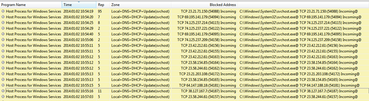

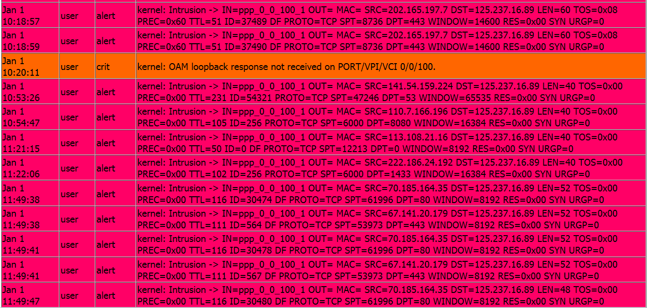

The log shows stuff like in the image below:
- but it is a transient in-RAM log and I couldn't see an easy way to automate the collection of the logged data other than what is suggested above by @Stoic Joker

By the way, I don't recall previously seeing the critical OAM loopback response error in the log - it's usually just all intrusion alerts, once the router has rebooted. (I periodically reboot the router from within the browser.) Maybe it was a momentary drop in service levels standards by the ISP?
Just referring to your image above, those are all TCP protocol, do you have incoming ICMP messages blocked in the router firewall?

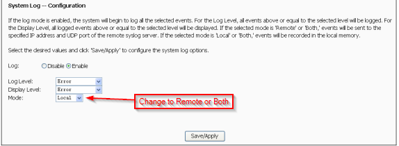

Re. the syslog server, your router is capable of sending the error reports to one - it looks like you have version 1 of the router going by the image in the other thread, so from the manual:
Mode - Select Local, Remote or Both. If the selected mode is Remote or Both, events will be sent to the specified IP address and UDP port of the remote syslog server. If the selected mode is Local or Both, events will be recorded in the local memory.
SJ will probably know for sure but I would have thought there was a way to have the events appear in the Windows Event Log.
Otherwise, Kiwi and PRTG both have a free version Syslog Server, (limited number of input sources), that should be able to do what you want.

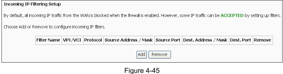

By default incoming connections should be blocked, (if the router firewall is enabled), so for ICMP messages, (pings), to be getting through there's usually a couple of places to check:
Check Incoming IP Filtering and ensure there isn't an Allow rule for ICMP protocol:

I am wondering why your software firewall is seeing a lot of inbound blocking activity if the routers firewall is turned on though, (it does support a SPIw firewall which should make it reasonably intelligent).
Referring to the W7FC image, you've cut it off so does it report what protocol is being used?
Don't know if this is feasible or worth bothering with, (SJ, 40, etc would be more informed than me), you have connection attempts being blocked to processes started by svchost.exe - it might pay to try and narrow down what processes in particular.  Possibly by using Process Explorer to get the names and trying to correlate with lookups on the blocked IPs.

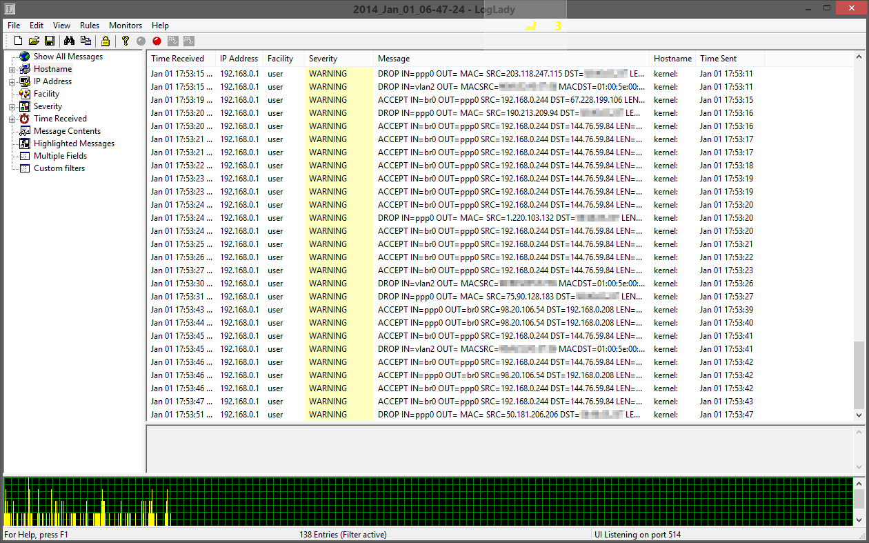

Addendum: Here's another SysLog Server that might be a bit simpler, LogLady - very small (2.30MB) and works quite well with my router sending messages to it.  LogLady's default port for your router to send to is 514.
Shareware, but you could use it for a short period to see what's what.

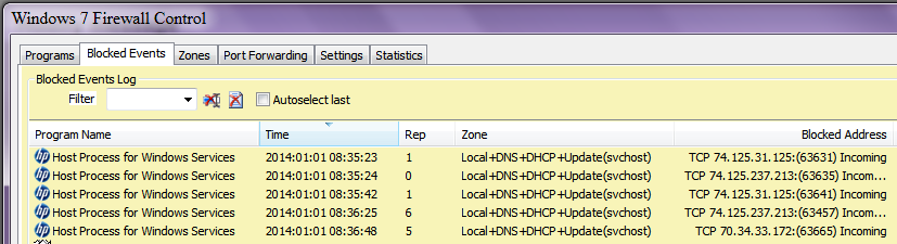

...Referring to the W7FC image, you've cut it off so does it report what protocol is being used? ...
Here's a fuller image sample (taken from SysExporter):
...Check Incoming IP Filtering and ensure there isn't an Allow rule for ICMP protocol...
==> I checked. There are no such rules set in the router. (I set up no Allow rules on Incoming IP Filtering.)
==> "Enable SPI Firewall" is ON.
==> See above latest image of log from me. It looks like it's all TCP.

You've got IPs from Amazon Web Services, Google, Akamai (CDN), Joe's Datacenter LLC (this would have to be the NSA :) ), etc being blocked.
I think you need to check what programs you've got installed that require contact with these services.
eg. Background updaters, sync programs, iTunes, etc, etc.
You can get a list of what programs have which ports open with
netstat -anob
But anything internally initiated shouldn't be getting blocked by the router. Conversely, anything blocked by the router will have been externally initiated.

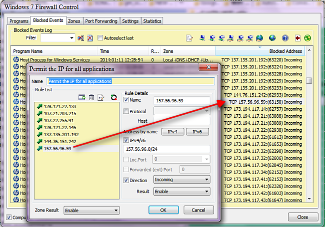

At the Blocked Events link, it said:
  Right clicking listed event (or using the toolbar) allows composing/adding a corresponding permitting rule to the application. The rules are created and applied (if required) to the blocked application to avoid blocking of the same reason in the future. Corresponding rules can be created/applied to all the applications at once by updating "Zone for All the Applications" (check Settings tab for the details). The blocked event destination address ownership can be verified via a free online WHOIS database.
    There is a set of options to set the permitting rule for the blocked IP only, IP sub-network, with or without destination port limitations at your option.
    The permitting rule is created automatically, shown in the final zone draft, can be edited and applied to the application (or all the applications) after confirmation. The rules are applied to applications listed in the Programs pane directly.

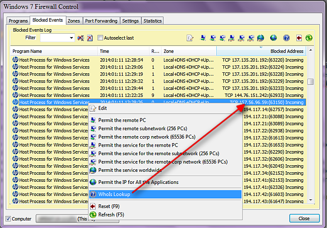

I then did a WHOIS  (using W7FC) to check a few (not all) of the incoming IP blocks in W7FC:
