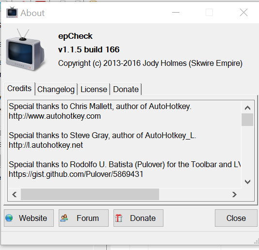

skwire got it I have other questions
1 here in this screenshot for this version on the weekly tab what is the number of future days set to when installed ?
2 Am not getting any listings for jimmy kimmel live and The late late Show with James Corden
« Last Edit: August 19, 2016, 02:44 AM by sportman12 »
    • Superboy Coder
Re: NANY 2014 Release - epCheck
« Reply #324 on: August 19, 2016, 02:21 PM »
Seven days ahead is the default.  You can change it to whatever you like.
Regarding Kimmel, it looks like the episodes are there but anything above episode #100 are displayed/sorted improperly (this is a bug).  Basically, they get display with a leading zero in the episode number like this: s01e0105  Because of this, they get sorted at the top of a season listing.  I'll see if I can find some time to fix this.
Regarding Corden, if you look at the TheTVDB.com site for season two, you'll see that there are no new episodes since 2016-08-04.  Perhaps he's been off the air the last few weeks because of the Olympics?  If that's not the case, you're going to have to wait until somebody enters in the new episode information into the TheTVDB.com site.  That is, epCheck doesn't make up episode information on its own; it only displays the information available on the TheTVDB.com website.
