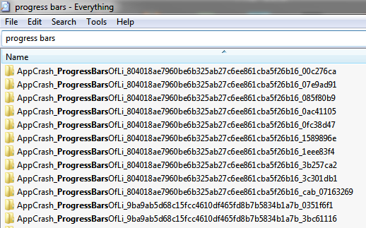

Thanks, Mouser. I've installed the latest version (though it seems to have the same version number as the previous beta?), but unfortunately I'm stuck with this access violation problem. After starting the app, I get the "EaccessViolation" message, and then "Access violation at address 6CA281FB. Read of address 6CA281FB." and then "Access violation at address 0077711D in module 'ProgressBarsOfLife.exe'. Read of address 00000005."
I also did a search for "progress bars" in Everything to see what has been created on my system, and I found the following folders with crash reports:
They are at C:\Users\Dr Andus\AppData\Local\Microsoft\Windows\WER\ReportArchive\AppCrash_ProgressBarsOfLi_804018ae7960be6b325ab27c6ee861cba5f26b16_00c276ca\Report.wer

Make sure program isnt running and then rename (rename not delete so you can get your old items back later) the folder My Documents\DonationCoder\ProgressBarsOfLife
That should remove any existing settings that must be causing the problem.
