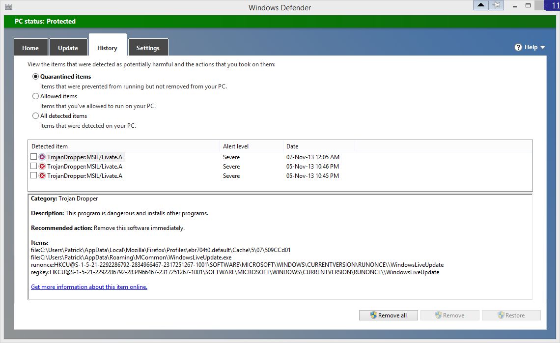

Does anyone know how I may remove Trojan Dropper:MSIL/Livate.A ?
I have had this Trojan hiding in my laptop for the better part of 3 months now.
Windows Defender detects it whenever it tries to do something, and this generally happens only when I start a new Firefox session or a new Internet Explorer session.
Windows Defender then detects it and quarantines it. You can see it in the attached picture.
After I instruct Windows Defender to remove it, Windows Defender deletes it and after making sure I update the signatures on Windows Defender, I do a complete entire harddisk scan and it finds nothing and then everything seems to be OK for a few days and then when I start a new Firefox session or a new Internet Explorer session, the Trojan is detected and quarantined by Windows Defender.
I have also bought the pro version of Malwarebytes but its complete and full scan reveals no such Trojan.
Likewise, I have runned Hitman Pro and it also finds no such Trojan.
Yet it keeps resurfacing and being stopped by Windows Defender but somehow not being completely removed when it is deleted.
