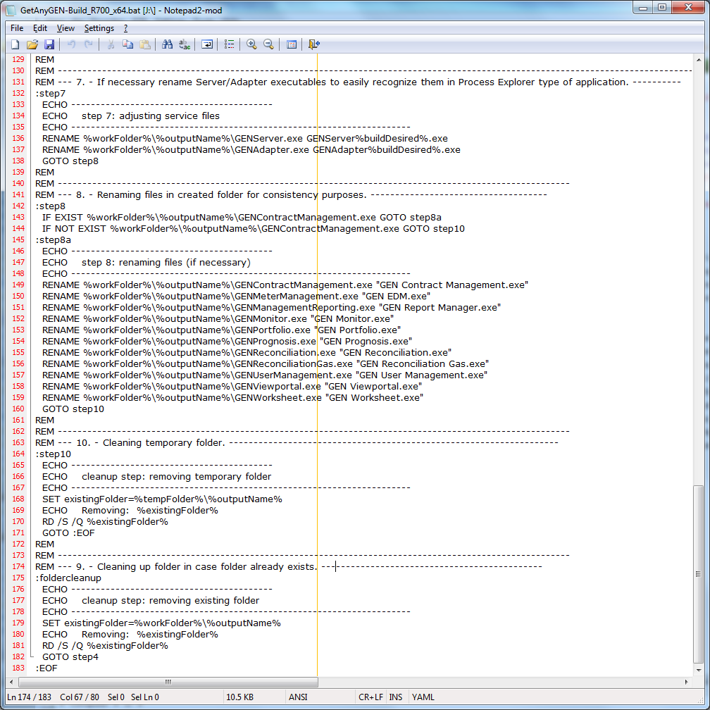

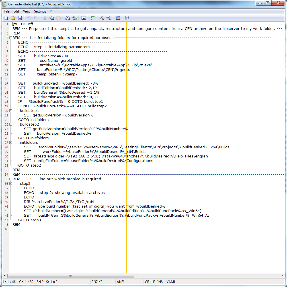

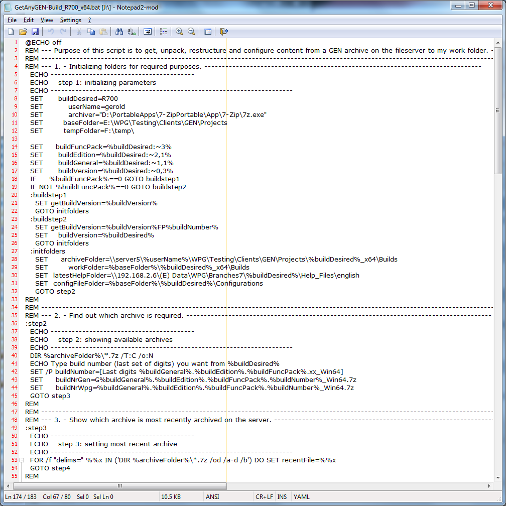

With the example file I used (a batch script with a lot of sections) I saw that when I selected the Py scheme as the syntax scheme for this file, code folding options appeared.
With its basic structure, only the YAML, Visual Basic, VB Script, Cmake Script and AutoIt3 syntax schemes showed somewhat similar code folding options, so you likely could use any one of these.
Then I manually indented (4 spaces for each indentation) the content of this file...same set of syntax schemes do code folding.
Replaced all spaced indentations with tabbed indentations and again only the same set of syntax schemes do code folding.
I think it is safe to say that the code folding functionality doesn't respond to the use of tabs or spaces. None of the code folding in the other schemes matches the code folding from the Python syntax scheme, though.

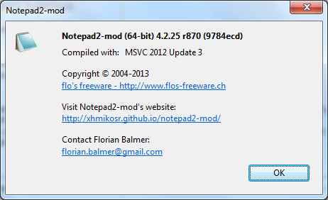

For this small test I used Notepad2-mod 4.2.25.870 (64-bit zip).

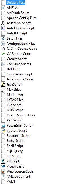

In Notepad2-mod, if you remove all the colour styles from the YAML parser, add the txt extension to it, (and remove it from Default), then it will do folding in plain text files on TAB indents.
If you're not likely to use YAML for anything, this is probably the easiest way.

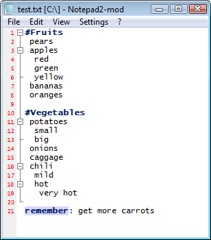

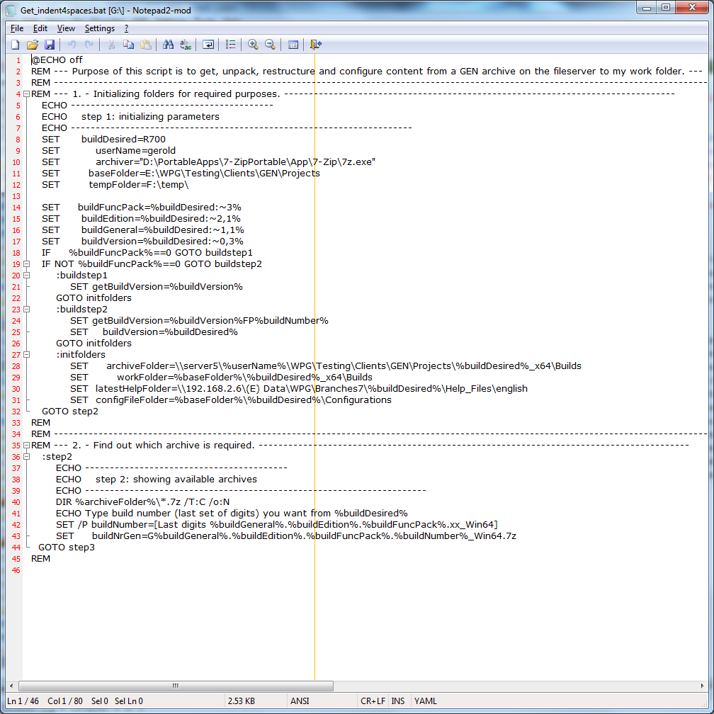

Jackpot! Thank you 4wd. Folding works. I specified the comment syntax (everything after #) as bold headings and any word suffixed with : gets color background. edit: three hypens ( --- ) at the start of a line triggers the "Document" syntax for YAML, which can be used as a colored horizontal line separator.
This is a very useful intermediate between "plain plaintext" and markdown.

« Reply #10 on: October 27, 2013, 01:01 PM »
Except for a slight colour difference to Nod5's, the settings are attached.
I recommend you Export your current settings in case they differ from the default, otherwise I've included the default in the archive also.
In notepad2-mod, View->Customize Schemes ... and then Import the .ini file.
*.txt will now be identified as YAML files when opened and the relevant formatting applied.
Change the colour and/or text styles to suit your needs.
You can use WinMerge, BeyondCompare or similar to see the differences between the default and modified files.

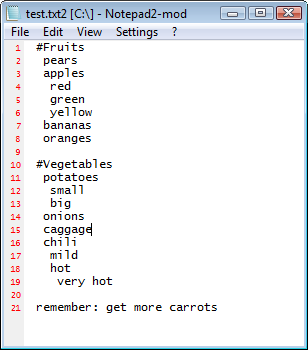

Now this is weird:
The first result from using YAML scheme went (very) wrong:
Re: notepad2-mod: custom code folding for txt files?
« Reply #12 on: October 27, 2013, 01:09 PM »
I noticed that when I was initially playing with it, editing things in and out but, as you found, reloading the file seemed to fix it up.
Do you have Insert TABs as Spaces set, (I do) ?
« Reply #13 on: October 27, 2013, 02:06 PM »
No, I didn't set that option, although I don't like to use tabs for indentations. But that is a discussion for another thread (which very likely ends up in the Basement after the tenth post... :P).

First click view > customize schemes...
Then in the popup window:
- Default text > associated filename editbox: remove txt
- YAML > associated filename editbox: add txt
- YAML >
comment: change to: bold; fore:#0A246A
identifier: change to: bold; fore:#0A246A;back:#D7D7FF
error: clear the style editbox
I think that is it. There are some settings left but I haven't seen them get triggered accidentally in any textfile so far. The popup has dialogs for quickly changing any color and there is a list of possible variables to use.
